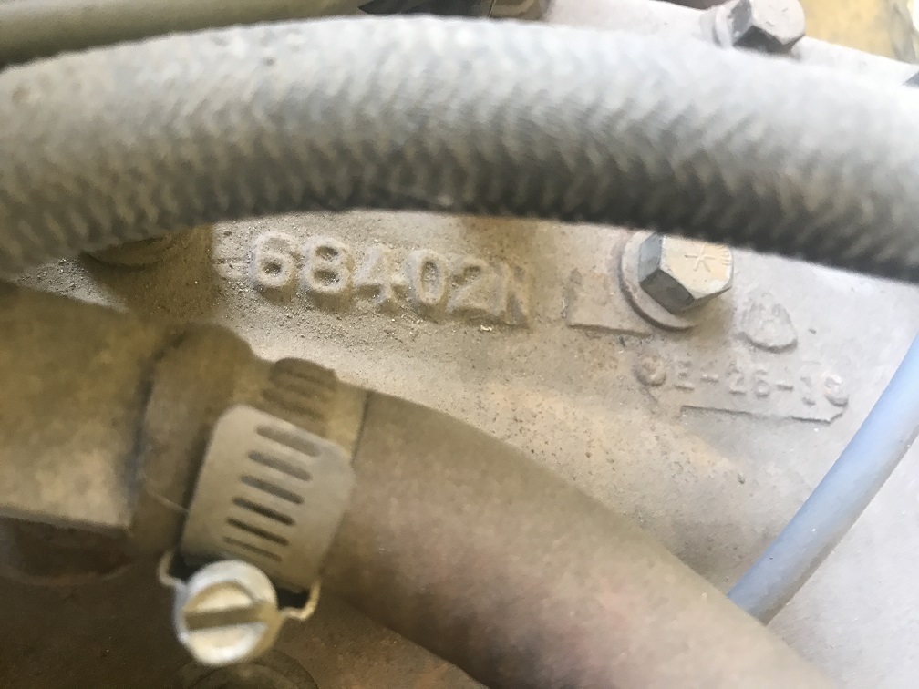

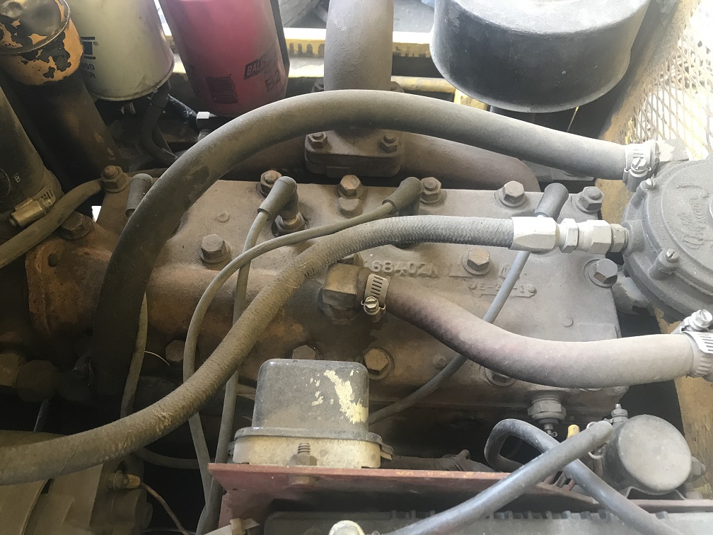

Hey All,
Have a AS FP 30 PS...  The engine has an oil/coolant mix problem but before I tear into it I want to know what parts are avialable, but to be sure of that I need to know what engine is in it.
It looks like a flat head 4 cylinder running on propane.
Engines on top of the motor are 68402N and E-26-3.
I'll attach pictures when I figure out how :)

I agree
Looks like a flat head 4 cylinder to me too
Gary

Thanks Gary, yes, but what engine? That's the hard part

Looks like it could be a Waukesha FCB.

I'd say you're right!  Now to find parts for it, any idea on a good place to look?  Or perhaps swap options?
