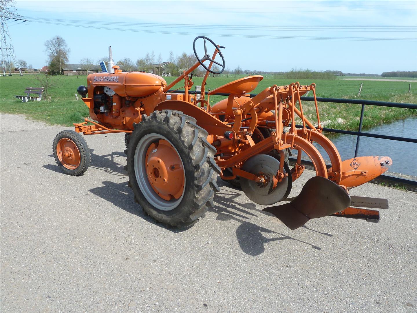

Mounted most of the pieces today. Still more to paint including both plows.

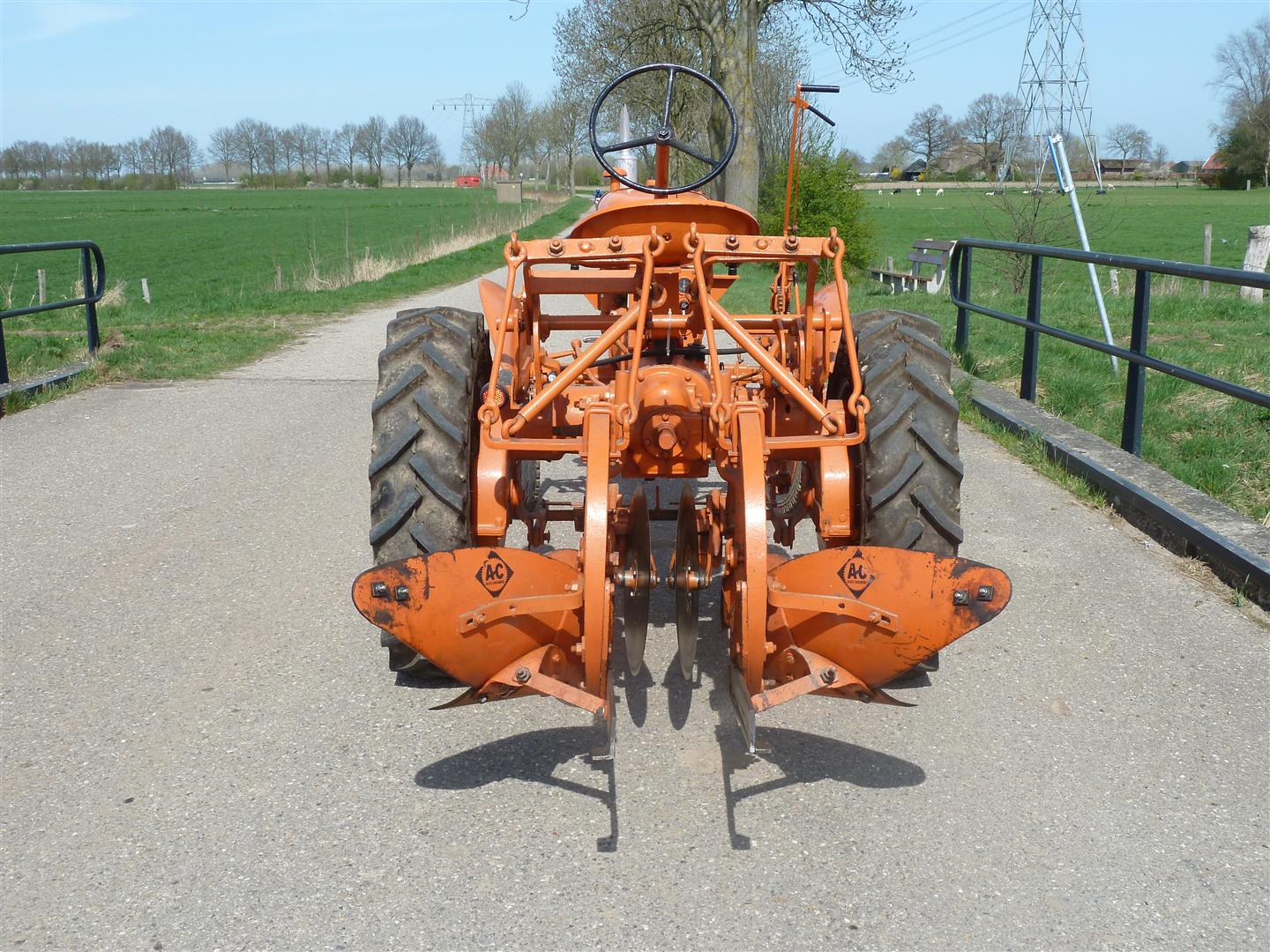

Do you know that you have a rear lift shaft from a C not the one that is used on a B?

Only Paul B and I would have  brought the C rock shaft to the builders attention. Get a B C mounted plow owners manual and see the difference.

Note the use of C wheel centers as B wheel weights
photos show correct B tool bar used for right/left tractor mounted plows
 Nowhere near as complicated a tool bar as on a C. One lever plow depth control
Edited by Ken in Texas - 28 Aug 2017 at 6:12pm

It came off a c parts tractor so your observation   is not a suprise. My question is does it make a difference in terms of plow position and function? I couldn't find a decent B rocks haft but I do have both. A b and c front drawbar and I see no difference in the location of the plow mounts. That being said the rocks haft mount points should be the same as well. Clearly the rockshat fits and the hydraulics match up.

It's my understanding that the additional lever, the left hand one and the additional width and complexity on the c rockshaft is for mounting the rear cultivators which I also don't have yet. I suppose I could have taken a cutoff wheel and made this one look more like the b shaft but the mounting holes would still been a little different and close inspection would have revealed it to be a counterfeit b rockshaft. Allthough I could have claimed that it was a prototype :).

From a strictly functional point of view, it will do just fine.  The C liftshaft is prone to getting clothes and fingers caught in the mechanisms, whereas that wont happen with the B liftshaft.  If you do find a nice B lift shaft and depth lever you will need a different connecting link to go up from the plow drawbar to the adjusting lever, as it will be longer and have greater bends in it.

As anybody who has plowed with tractor mounted plows on a B or a C knows. With each land you plow you follow in the furrow of the previous land with the rear tire and front tire. You may have adjust the  front and rear tread width of your B to the same width as a C to use the C tool bar for plowing.
Being your B has the reversible C wheel centers I presume it also has a adjustable wide front.  By turning the rear wheels around and playing with how the rims bolt up to the centers, you may get the tires to follow in the furrow of the previous land. Both the front and rear tread width need to match and follow in the furrow.
    The C plow tool bar may not work right at all on a B with a Fixed non adjustable narrow tread width.
    See how close the right and left  plows are together on the above B Pictures.
    I wish I had a picture how far apart the plows are on a C with the wider tread width.
    With the rim to wheel center offset you have on the B now, the rear tread width  may be pretty close to what a C tread width is set as narrow as it will go
