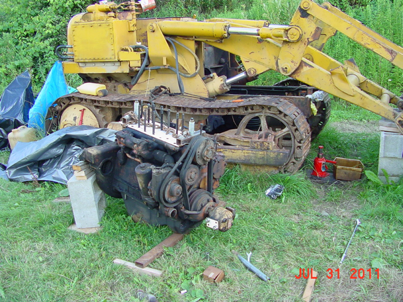

You should investigate the reason your HD344 will not turn. You will have to do some disassembly even if you replace the whole motor. My HD344 came to a screeching stop and locked up because the generator pulley was not turning.
If you choose to remove the loader it is helpful to remove the cylinder head. I had difficulty lifting the motor with a loader with a 3/4 yard bucket. Prop the loader up as shown in the picture.
