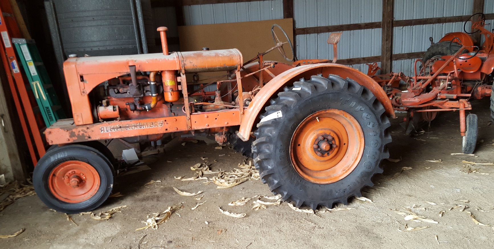

Needing some help. Auction coming up some F&H 161 weights and I'm curious if they will fit the rims on my WC (in the photo). I've read some past topics that for the spoke rims the F&H 161 is the 'inner' weight and the 162 is the 'outer' weight. I believe the 2 holes on the rim are 18 inches apart. So not sure how they would work with these rims. Installed some brand new FireStones' without fluid and she's a little light in the rear end for plowing Thanks!

Yes, the 161 is the inner or starter weight and the 162 is the outer or add on weights for the spoked and stamped wheels. The 161 is not used on the casted centers.

Center to center measures 14.5 inches on F&H weights. I have them on my WD45 and Dad's 185.
