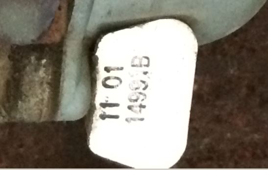

My Series 1 D17 loses all power, and sometimes dies if heading uphill.  Is this a float problem?
Gas tank is full.
If I stop and wait a minute, it will line and and run again, and if I point its nose downhill, it will run fine.
It has a rebuilt carb on from Steve at B&B.  Below is the tag on the carb.
