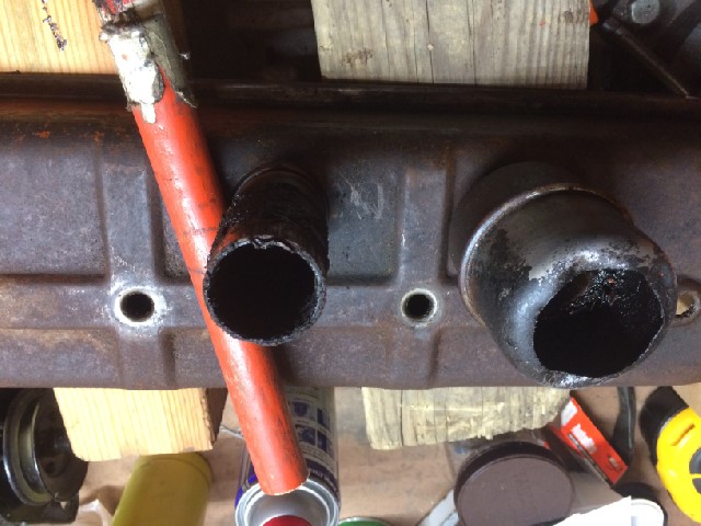

Well, I have won this battle! I put the valve cover upside down on two 6x6 blocks, inserted a short length of broom handle and drove the cap off with just a few solid raps from the plastic hammer - distorted the top of  the cap a bit but that has been fixed.
Below is a photo before I began the cleanup effort. The volume of crud is hard to see, but I consumed several shop rags and lots of solvent cleaning these parts! Valve cover and cap are now cleaned and primed. Smile
Thanks for all the ideas!

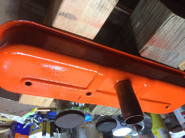

Another photo after some primer and PO#1. Sorry it's upside down - not sure why THAT is happening! But it still looks a lot better.

Good job,
Is there supposed to be some packing in there to act as a filter?

re: upside down...
those fancy 'edevices'(aka smart phones) have an option for 'locking orientation' or some cryptic wording.... it keeps the picture the way you took it,right side up....
at least that's what I was told......
FloydKS View Drop Down
Location: S E Kansas
Points: 8402
Post Options Post Options   Thanks (0) Thanks(0)   Quote FloydKS Quote  Post ReplyReply Direct Link To This Post Posted: 22 Dec 2016 at 8:49am
You said you turned it upside down on the blocks to get it off...the picture thinks it should be that way.   :)
good job on completing the job...and a job well done.

There was and still is some steel wool-like material in the upper half behind the inner shell and above the shelf with holes.
I pulled the rocker arm assembly and the baffle off and cleaned them. There was nearly 1/8" of sludge on the back of the baffle and lots of sludge stuck to the assembly. They were a lot cleaner when they went back on the tractor! Reset the valve clearances after I pulled it in the shop while it was still warm - they were all at least .020 vs the .012 they're supposed to be.
Several of the rocker arm pads appeared to be worn down by the valve stems - are those pads supposed to have a "ledge" or are they supposed to be flat?
