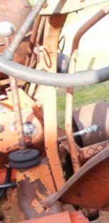

Post Options Post Options   Thanks (0) Thanks(0)   Quote DaveKamp Quote  Post ReplyReply Direct Link To This Post Posted: 27 May 2010 at 1:33pm
Sorry for not specifying- I didn't know there was a difference... After exploring my IT manual, I didn't see any indication of uniquity...
This is a straight shifter-  straight up out of the transmission....
With an interesting, but I'm thinking aftermarket shift knob...
Edited by DaveKamp - 27 May 2010 at 1:35pm
Post Options Post Options   Thanks (0) Thanks(0)   Quote CTuckerNWIL Quote  Post ReplyReply Direct Link To This Post Posted: 27 May 2010 at 8:42pm
Do like John said, take a look and see if anything looks worn. If you can't tell what the problem is by pulling the shifter, pull the cover and have a look.
