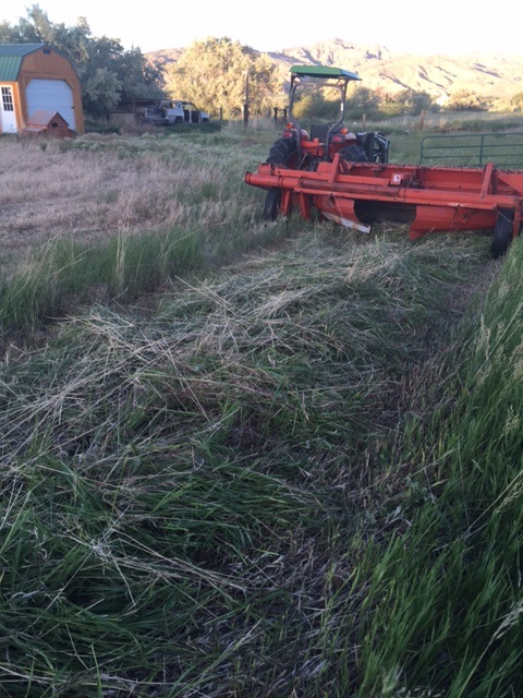

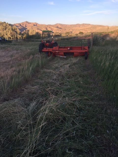

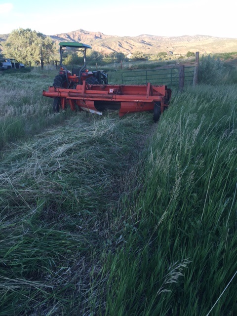

I've never hayed before, so bear with me.  I have an old AC-829 pull type swather and will be baling with a AC-303 wire tie Bale Chief.  Both pieces of equipment had been sitting for some time, but I think I'm getting them going again.
My main questions right now are on the swather.  I've been working on it for some time and today got it running and cut about 30 yards with it.  I would compare the grass to CRP grass as it has not been grazed or cut for 1-2 years.  I ran the PTO at 540, and had the tractor in first gear.
Attached are some pics.  What do you think?  I've never hayed before, so this is the first windrow I have made.  And I have a TON of questions:
1)  Will my baler pick this up, or should I rake two of these windrows together?
2)  How wide and tall of a windrow should I shoot for?  My neighbors windrows are much taller and have much more grass in them, but he uses a bigger swather and I'm sure he irrigates much more effective and fertilizes.  I'm sure he has a much better baler too, lol.  What are your thoughts on this specific to my old AC equipment?
3)  How far off the ground should the cuter/sickle bar be when cutting?
4)  I'm in northern WY and its very dry here.  How do I know when its time to bale?
5)  Any other words of wisdom you have for me?
Many thanks in advance!!

1. The baler will only pick up a windrow that is as wide as the baler pickup or narrower.
2. If you are shooting for dry hay to bale, then the wider the windrow, the better. The higher (and thicker) the windrow is the harder it is to dry.
3. Set the sickle to cut about 3 or 4" off the ground.
4. In Wisconsin, straight grass takes 2 full days of sun to dry, WY might take a little less.
5. If you are new at haying, don't jump the gun on baling, when you think the hay is ready to bale, wait a while longer then bale.

Hello Mike, Welcome to the AC site... best in the land of Allis-Chalmers...the right place to ask questions. Sometimes its fast answers, and sometimes it takes awhile.
 First off, I am looking at your pics, I have never run an allis 'swather', which is actually called a haybine, because you are combining three actions into one... Cutting the hay, crimping/crushing the hay in the rolls and laying it in a swath of desired width.
 But anyways, the swath you are making doesn't look like it is going through the wings, more like just fgetting out of the rolls and laying down on the ground.
 Do you have a panel ahead of the wings knocking it to the ground?
 On the haybines I have used, I set the wings for the widths of the windrows and how fast for it to dry. wider the better for fast drying, narrower for keeping some moisture in if your not going to get to it right away... in a day or two but three of four...  Rain coming, and need to cut, layit wide so when the sun comes out, it will dry better.
 On the allis haybine, the drive that turns the rotary motion into driving motion for the cycle, is notorious for giving troubles. Make sure that gear box has oil in it at all times... and if its leaking, get it rebuilt before it gets ruined. no parts left for it except for scrapped units and they are hard to find. I have one that the box is gone on. Stern Smile
  We had an old haybne that we used and it was heavy , but it crushed the hay very well and layed it in windrows and we never raked the hay, but then we got a 990 IH that no matter what we did with it, the windrows didn't dry very well so we had to rake every thing if the hay was heavy.
Windrow for the baler is best if you can have it uniform in width size and density, but thats not in my world. and don't try to make any speed records either...  hope everything is in good condition on your baler... like the knife on the blung is sharp, nd of proper distance between the knives, and the knotters are well greased and not rusty... oh yea, you have wire tie never mind.. somebody else will have to tell you on the ins and outs of wire tie, I only dealt with twine.  And don't bale anything that is wet green, or you will be replacing shear bolts and having moldy hay or  worse scenario, bales that get hot and set the barn on fire. Good luck.

looks like it's cutting good. i'm sure that size windrow will be just right for your baler. you can judge how fast/slow you need to drive in different conditions as to how things work the best. how much do you have to do? if you find a big rock...stop and pick it up! balers don't like them much. bale as many snakes as you can, the rest of them will soon leave to the neighbors! welcome to the forum! and don't worry about asking questions...that's how you learn! and shut everything down before messing with your equipment! and STAY AWAY from that PTO if it's running!

I would open the wings and try to get hay to slide on them. They get rusty from non use and need polished up. Also there is a panel in front of the wings that is held up with springs, if I remember. Make sure it is all the way up when you are mowing. If you get it to make a good windrow you will be able to bale without raking. I always seemed to have better luck with alfalfa than grass. I'm sure your grass is different than mine in Iowa. We have mostly brome.

Looks good! You must have gotten that round belt in there to run the sickle.
If your sickle is in good shape you should be able to mow at least 5mph. The guy I bought my 829 from said you could mow easily at 6-7 mph in alfalfa. With that said you should mow at a speed you are comfortable with but I would mow atleast 3mph. Anything less and your machine will bunch the hay in piles due to material not running through at a speed slower than the reel.

Hi SLee,  I do have that panel and it is held up with springs.  I'm thinking that because the tractor was going so slow, the cut hay was falling out before it got to the wings.
With that being said, I can't cut anymore until I get my baler going.  Hopefully this week.

I think you're right Jim.  I need to go faster.
For the belt, I havn't replaced it yet.  It looks horrible, but is working.  I did order a belt and got it yesterday just incase it breaks.  Many thanks!!
