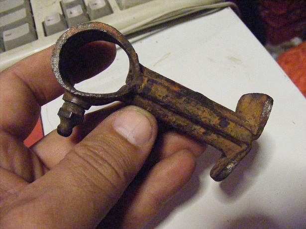

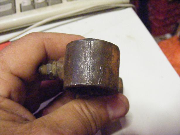

I found one of these supports and was looking at how it would have been mass produced,it's interesting.
In this first picture, you can see where it looks like it was stamped,but was it one piece of flat steel?,,or was it two pieces and then pressed together while hot?
Then you can look at it from the side, and it sure looks like it originally just one flat piece of steel,,,does anyone have any Idea?
I'm curious because it looks like these didn't get greased like they should have and I'll bet a good ones hard to find.
By the way,,this would be part number 220394 in the AC manual

I would guess you are looking at a parting line from a die. It may be a forging and the line is where the dies part.

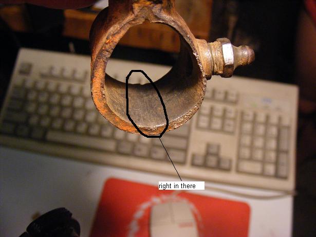

The thing that makes it interesting is, the parting lines are also on the inside of the loop on the inside too!
This is what makes me wonder if it was two pieces?,,,maybe?
