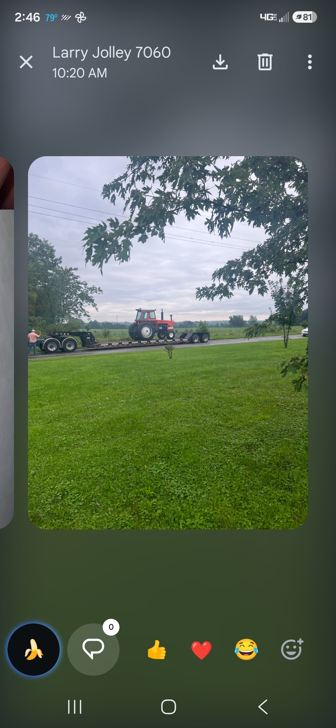

whatscooking View Drop Down
Joined: 08 Oct 2017
Location: Indiana
Points: 301
Post Options Post Options   Thanks (0) Thanks(0)   Quote whatscooking Quote  Post ReplyReply Direct Link To This Post Posted: 14 Aug 2026 at 1:48pm
Points: 5690
Post Options Post Options   Thanks (0) Thanks(0)   Quote AC720Man Quote  Post ReplyReply Direct Link To This Post Posted: 14 Aug 2026 at 2:45pm
Wow, that is a beautiful tractor!! Congratulations
