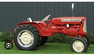

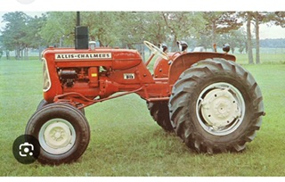

Since repairing the front wheel on my D12 series 3 I have decided to replace the tires instead of reinstalling the old ones. In the post a few days ago about wheel repair options Gary posted a reply that included a link (thanks again) with info and a picture of a D12 series 3. I like the looks of the tires in the picture much better than the tires on my D12. I have been trying to find out the tire size…with no luck. I found a couple of pictures online of D12’s and the tire size is obviously different. I will try to post both pictures. If anyone can help identify the larger tire size … many thanks. Currently I have 5:00-15
Points: 22851
Post Options Post Options   Thanks (0) Thanks(0)   Quote DrAllis Quote  Post ReplyReply Direct Link To This Post Posted: 05 Feb 2025 at 9:20am
The picture on the right are 14.9 x 24's, which was an OPTION on the later series. D-10-12.  I just installed a set of 13.6 x 24's on my D-10 which replaced a pair of 11.2 x 24's. A big difference for sure. The larger tires may cause you to run the wheels out from the fender one setting (2 inches) to avoid contact.

Thanks Dr. But I was referring to the front tires. I have 14.9-24 on the rear but like the looks of the larger front tires

I have similar GM rims on my WD project as seen on the right photo. Tire size is 7.50x15

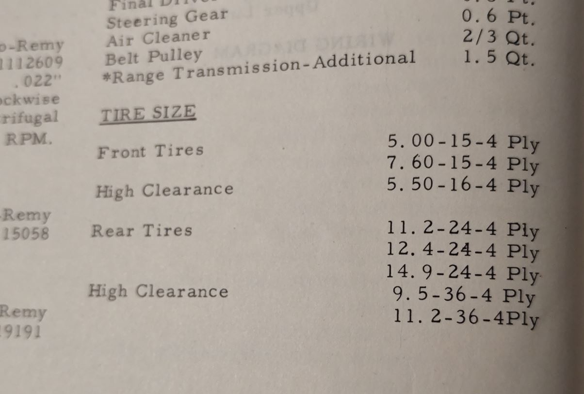

Here's a pic for a D12 series 3 operators manual.

Thanks everyone. After seeing the info I looked at AGCO site for D12….. I guess I should have started there. I see the larger tire size calls for a wider wheel but also found on the AGCO parts site for D12 calls for a different hub for the wider wheel. I don’t want to get into all that change just for the looks of a bigger tire. Like Steve said just looking for a bigger tire that would work with the wheel I have and not rub the spindle.
