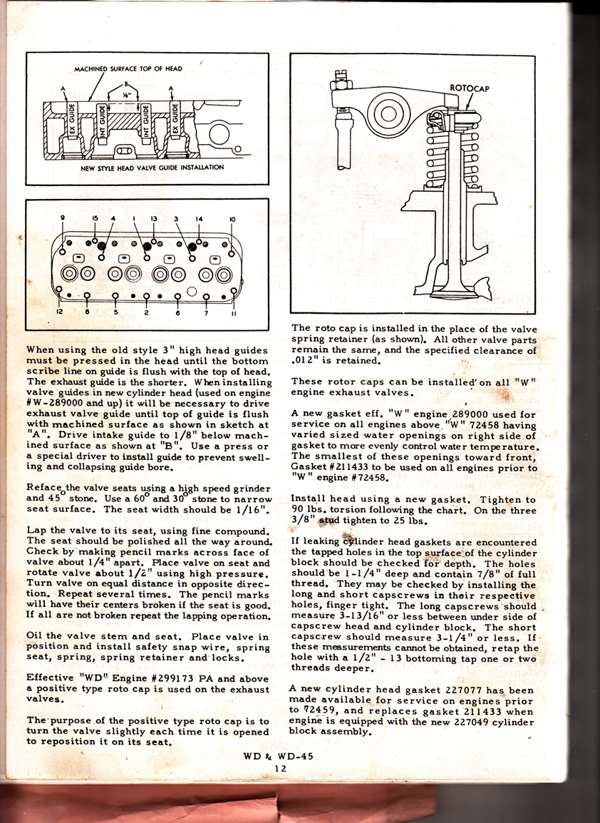

Post Options Post Options   Thanks (0) Thanks(0)   Quote RickM(MO) Quote  Post ReplyReply Direct Link To This Post Posted: 28 Jun 2016 at 12:02am
Ashaman, I took a closer look at the Parts Manual and if you have a 1950 WD with Engine No. prior to 289000, then it has all studs and no capscrews. So you were right about the studs all along. Attached is a copy of the Parts Manual Page 43 and Service Manual Pages 11 & 12, in case you don't have them. You said you torqued the studs to 75 lbs. For what it's worth: Page 12 of my Service Manual says to torque to 90 lbs. which I assume is for the 1/2 dia. capscrews on the later heads. My book doesn't say what to torque the studs to and it depends somewhat on what steel they are made of, so hopefully you are Ok at 75 lbs. Maybe someone else will know for sure.

Post Options Post Options   Thanks (0) Thanks(0)   Quote SteveM C/IL Quote  Post ReplyReply Direct Link To This Post Posted: 28 Jun 2016 at 1:08pm
and here's the screwy part...my 45 has 4 studs and the rest capscrews.Studs are fine thd on top and there is no mention of diff torque but you know the clamp will be diff with fine VS coarse.

Post Options Post Options   Thanks (0) Thanks(0)   Quote Ashaman Quote  Post ReplyReply Direct Link To This Post Posted: 01 Jul 2016 at 1:27am
Now that really is weird. I'm gonna have to go look at my '54 WD parts tractor/long term project and see what it has. I ran across the 70 or 90 ft lb debate, and it seems that only the 226 engines had the 90 ft lb spec, where the 201's are 70. I basically got the studs nice and tight and then torqued the nuts to 75. It's had coolant in it for a day and a half now and no apparent seepage down the block, so that's good!
