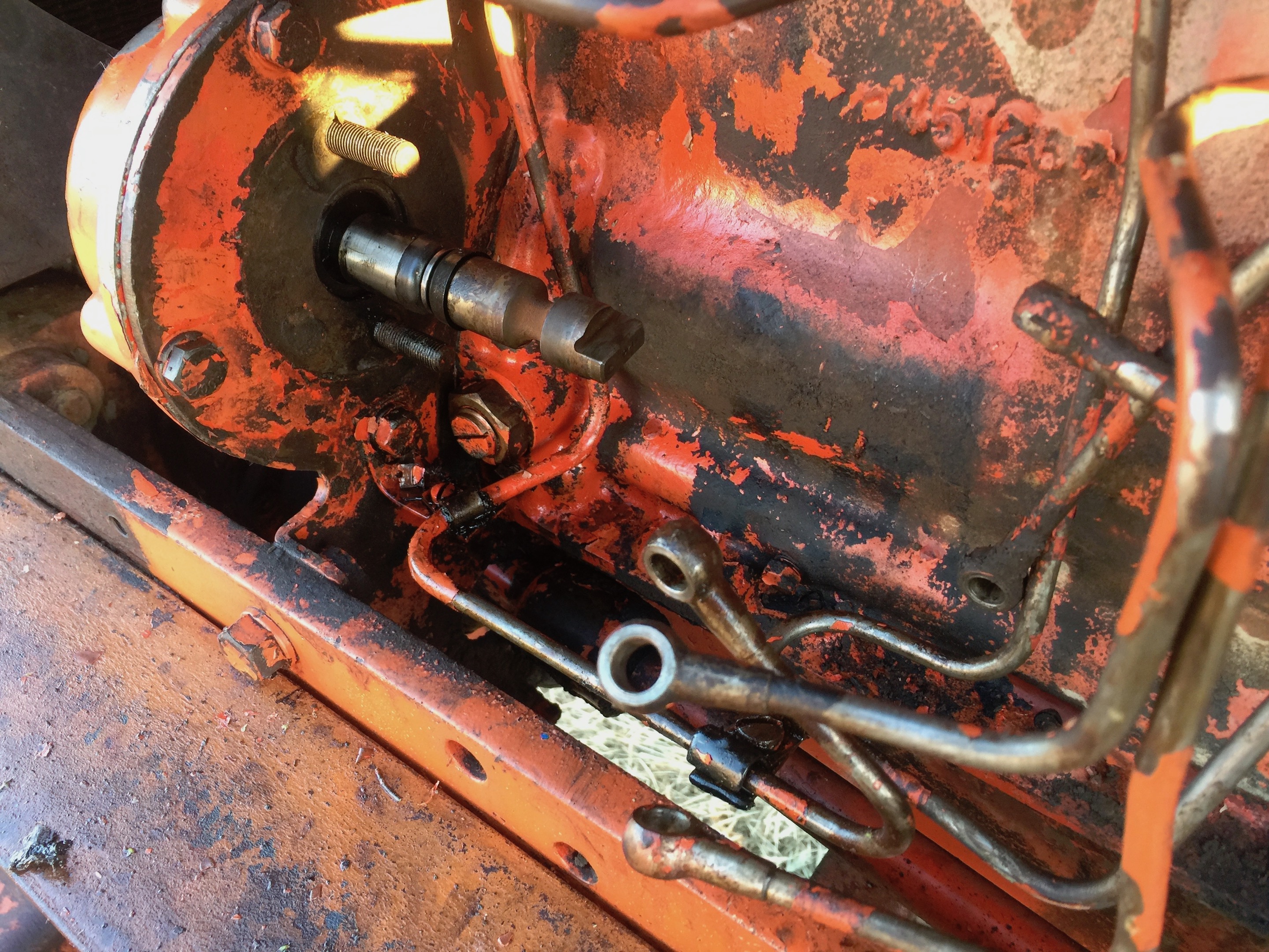

   SO I first removed the timing window and immediately found the stationary mark in the pump but I turned the engine over , and over, and over and never found the other timing mark on the turning part of the pump. SO I just made my own mark. Then I moved on to removing the pump. I undid everything, the lines the linkage, the 2 studded nuts and then attempted to slide out the pump. Well it came out but there is still a stub shaft stuck in the engine! See picture. So now what should I do? DO I need to remove the front cover to remove the stub shaft or can I slide the pump back in after rebuild back onto the stub shaft. That doesn't really seem like the right way. But I don't really know at this point. uploads/9178/IMG_2533.jpg

I hope you had the timing marks on the front of the engine lined up too. When I took mine off the series 4, that shaft came out with the pump. Some of these other guys that are more knowledgeable on this will chime in tomorrow.

Shaft should stay in motor. If the weight retainer is not replaced your mark will work.        MACK

if I look into the hole in the pump where the shaft goes and it has the screwdriver type slot in it, so apparently as long as I don't turn the engine I should be able to put it in only 2 different ways right? the right way or 180 off. And Also when I look in there, there is a difference from one side of the slot to the other which means I can tell whether the pump will be in the exact spot or 180 off. This would be regardless of my mark. I am going to make a note of this so when I get it back I should be able to put it in same way. Now there is some seals on the stub shaft I guess I better hope I get these when I get the pump back? My last concern is wether the rebuild guy be able to spin the pump without me sending in the stub shaft? I hope so as I like the idea of not removing it. I didn't mention that this tractor has never run since I have owned it so I guess I really don't know if the pump was in the right place to begin with but it doesn't look like anyone has removed it in many years if ever.

There should be a timing mark on the pump. Set it there and mark the engine while the pump is set at that timing mark. Just know that if you turn the engine after the pump is removed, you'll need to turn the engine a full two turns (720 degrees) before stopping at the mark again. Otherwise you'll be off 360 degrees. Always turn the engine in its normal rotation. If you try to back up to the original timing mark your gear backlash will throw the timing off a few degrees.

A good pump shop does not need the shaft from the engine, and should also send the cup seals and banjo washers. Just put the pump back on with the tangs matching dot to dot. You pump rebuilder should be able to coach you through this some. If not, time for a new pump guy lol!
