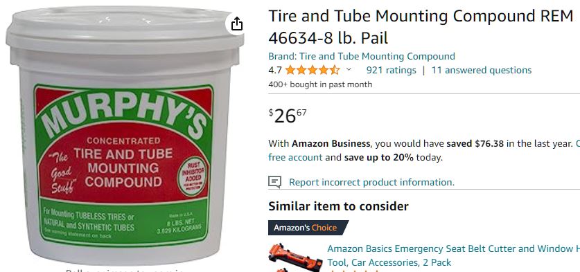

I have use laundry soap for the past 50 years... Saw the discussion on "tire soap" over the summer and bought this 2 months ago.. I have done 6 tires since then..
Makes it VERY easy to mount them, dismount them, and seal the bead as you blow up.. IM AMAZED !! ... Wish i had done it 50 years ago !

It is great stuff!

Just keep the bucket lid sealed when not in use as it seems to react to air and other things of setting open . Son had a 5 gallon bucket and keeps lid on as well as a plastic cover over the product inside the pail

I wouldn't ever go back either. I even use that stuff for things like slipping new rubber shift boots down the shifter lever, too. Just a small smear and they slide right down.
I have a gallon jug of concentrate, so not sure if it's different enough from yours... but I did note on the back it says to not let it freeze, so check for that. I bring it into the house in the winter.

yea, for those that are not familiar with this, the "bucket" version is not a liquid. I is somewhat thicker...  Semi solid .... a cross between peanut butter and Snot..  Wink
