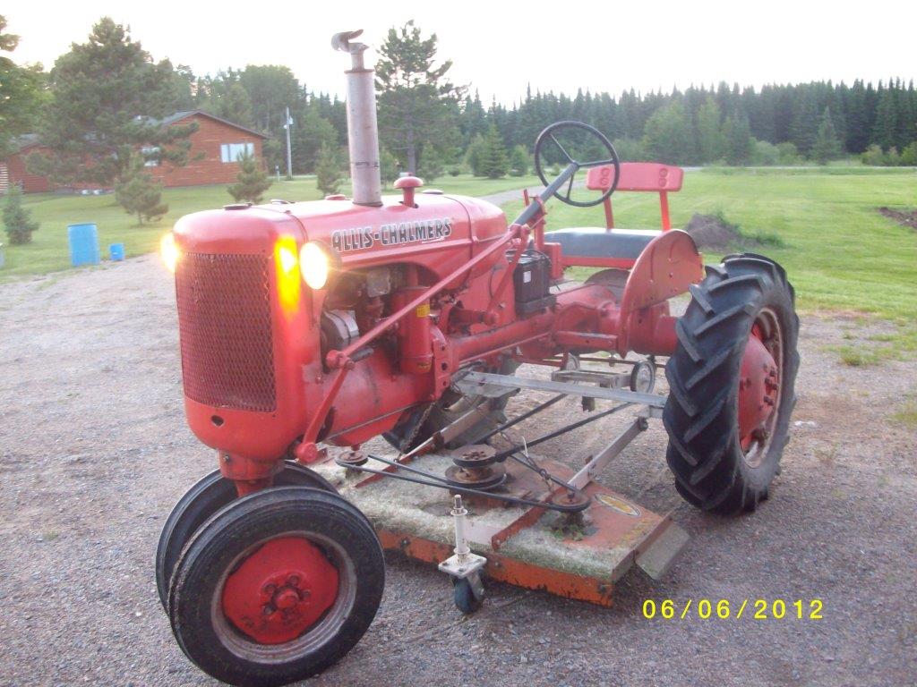

Here is my C with the Sunmastr deck. Belt guard removed, front wheels are not Sunmastr, I added them later.
Creek

Thanks for posting that pic Creek! Showed me that my crose bar was on wrong. Explains way the pto drive belt was a pain.
Here are the pics on mine.
