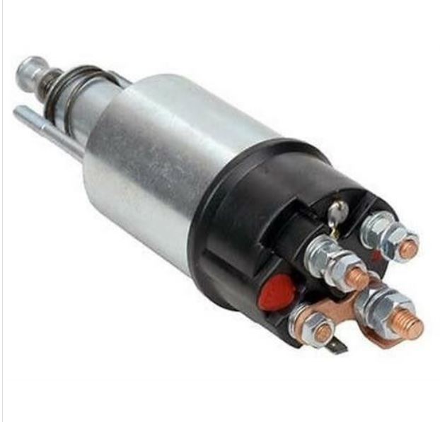

Is there any way to fix a starter solenoid that won't engage the bendix plunger? I jumped power from the battery terminal to the start terminal and it just hums a little bit. Is the only solution a new solenoid?

 It depends which kind of solenoid you got. I have taken apart the GM style solenoids and rotate the contacts inside and make em last another 50,00 miles but the fender mounted styles like the Fords use are not repairable. As a rule, the solenoids either work or they don't. The humming may be an issue with the brushes or a short of the armature to case ground. I'm not much help,,,,,,,

there are two studs on the solenoid.. If you JUMP them together, the bendix should pull in and the starter spin.... if all you get is a HUM, you have additional problems with the bendix / starter.

Ford style ... drill out the 4 rivets, 'dress' the contacts or flip over, use 6-32 N+B to reassemble the unit...
the 'trick' to ALL solenoid reapirs is to be 100% sure the contact MATE totally flat...
alway wondered how big a cap you'd need to quench the inrush current arc. I suppose that's on the web somewhere.......

Yeah Steve I can jump the two studs and the starter will take off spinning, but the bendix doesn't pull in.

It is on a Ford engine, but it's a Lucas starter/solenoid.

loks like a 'use once-buy another' style unit........sigh
I'm guessin $200 ???

If you can get the solenoid off the starter (you may have to pull the starter to do it),  You may be able to pull the plunger out of the solenoid.  It might be dirty, or rusty from setting, and cleaning an a light wipe with oil well make it go.  The Bendix might be stuck on the shaft and not moving as well.  Have you tried tapping, in a technical manner of course, on the solenoid and rear of the starter housing behind the solenoid while trying the starter?

Jim...I've got it off the machine and tried all of your suggestions. No luck. With the solenoid off, I can reach in and move the linkage with 1 finger, and the bendix slides smooth as silk.

Sounds like you need a new solenoid.

Post Options Post Options   Thanks (0) Thanks(0)   Quote CrestonM Quote  Post ReplyReply Direct Link To This Post Posted: 29 Jul 2020 at 9:44pm
I agree. I ordered one, so it should be here Monday. If the starter gives fits down the road I'll put in a gear reduction starter.

they usually have a pull-in and a hold winding, pull not doing the job, hold is 'humming'
