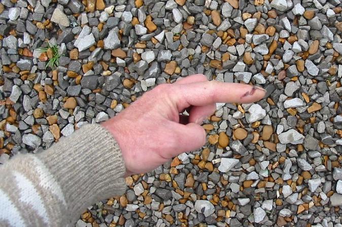

Six days ago, I took the post hole digger off the 3 point hitch of a Ford tractor, working by myself instead of waiting for my wife to help.  Mashed the fool out of my finger when I laid the beast on the ground.  I've never owned an AC with snap coupler.  How does it work?  Can it lift implements up/down.  Why did this system loose out to the 3 point hitch?  Just curious.

Sorry to see/hear that finger ! Been there..done that.
The easy cure is to have two tractors,one 3point, the other sc. I bought a [Ford 2n] so that I could 'timeshare' implements with neighbours.
Now that I have 2 D-14s I'm looking to make an SC/3pt adapter then I can sell off the unorange tractor,although it is fun to drive on my 'huge' 1 acre 'farm'.
