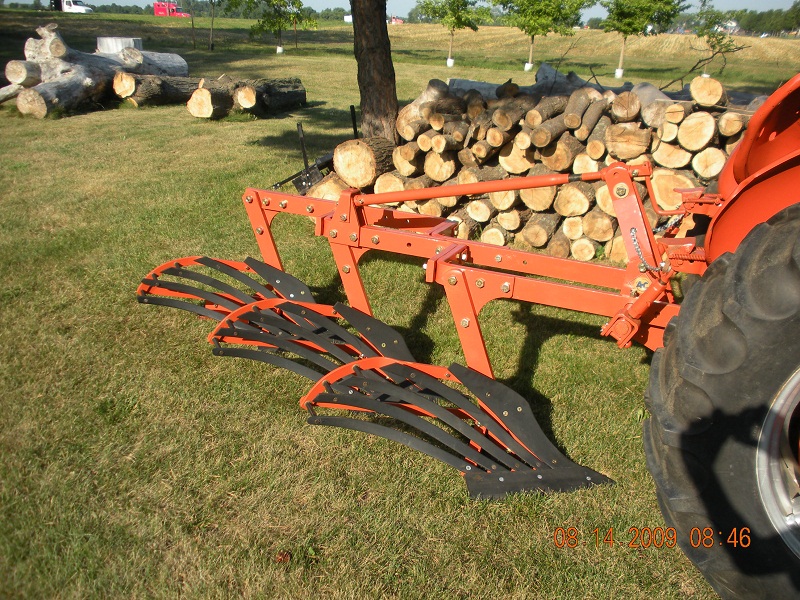

They sure do, and you don't see a lot of them restored. Here's my 73 with slats right after it was finished, I wish now I had kept it just for show. I could never get it to work right with the traction booster, it was a lot of plow for my WD in our heavy black dirt.

70 series worked best with the adjustable depth tire on the rear. Not a tail wheel that lifts, but a 15 inch car tire to control max depth.

I know, I couldn't stop it from going too deep. I was looking for a fixed gauge wheel but never found one before selling it.

 Sorry to hear you had so much trouble with that plow. I have a few of the gauge wheel assembly’s . I always took them off, never liked them. It’s a long plow for the W series tractors. We pulled them with a 45 and remember once the depth was set the rear bottom would about drag on the ground when up in transport.
