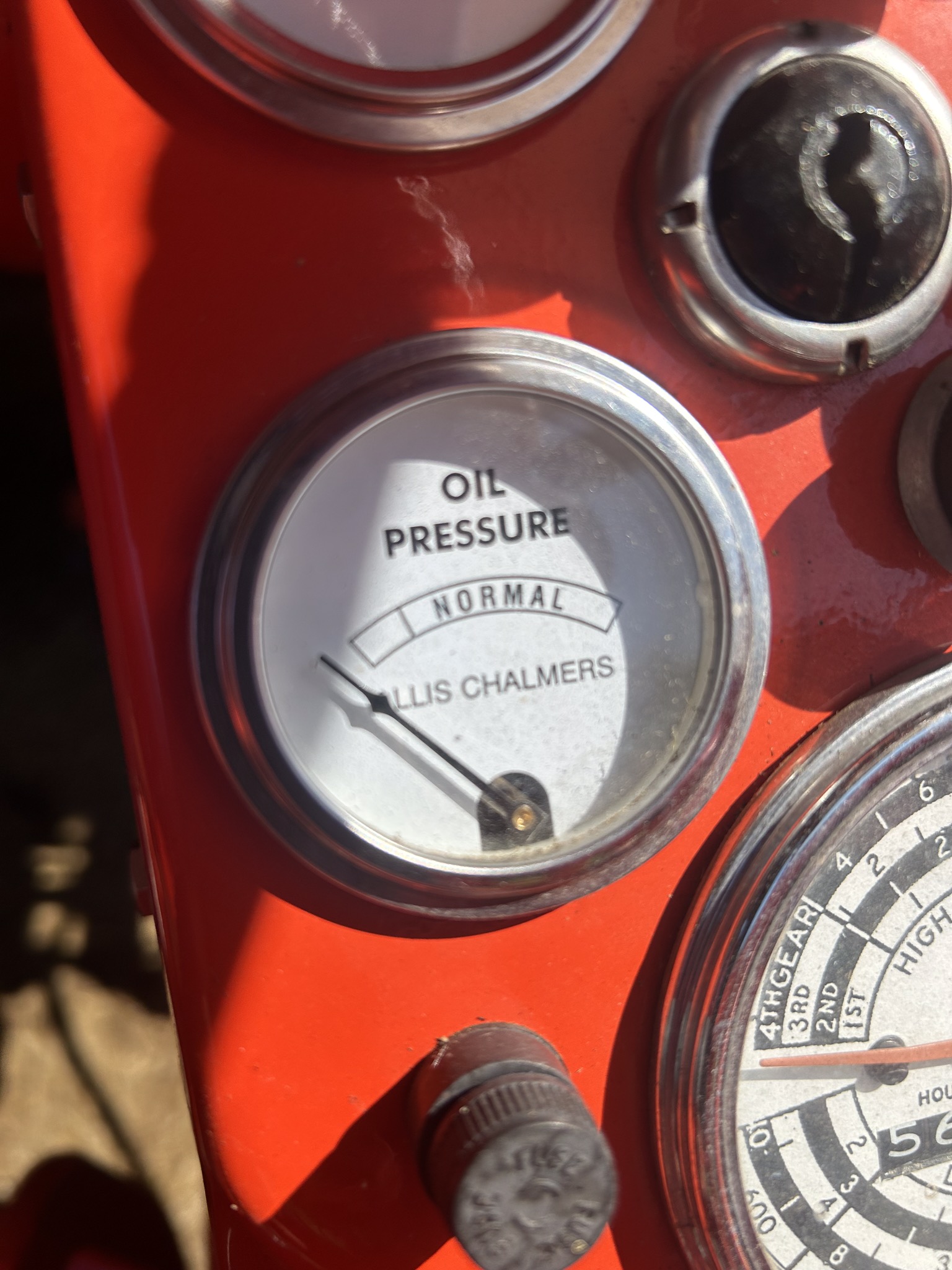

Post Options Post Options   Thanks (0) Thanks(0)   Quote AC720Man Quote  Post ReplyReply Direct Link To This Post Posted: 10 hours 46 minutes ago at 3:52pm
My series one D17 diesel has a factory style “Normal” gauge in it. New Agco gauges were installed when I freshened up the tractor 2 years ago. Engine has not been rebuilt that I am aware of. On cold start the gauge goes up to the A of the gauge, once it warms up and I’m sickle mowing for instance, it runs in the R or M of the gauge. Low idle it will drop back to N. With that being said, I was told that they are 60psi gauge. Sounds like it’s right in line with what Dr Allis is stating IMO.
