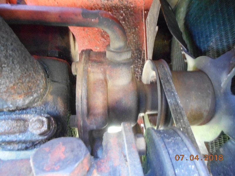

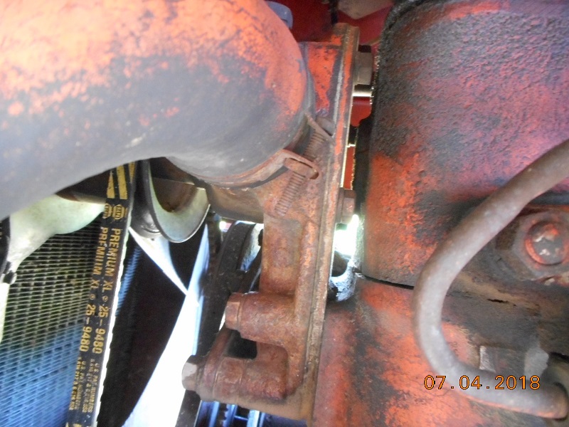

Here are a couple photos of my D19D pump. The metal line you mentioned is the one I had to shorten and reconnect with hose and clamps, due to a variation between my old pump housing and the new one. It uses 4 bolts (3/8") to mount to the block. A lot of sites show the casting numbers on the pump housing for reference as well. HTH

Yes Yes that looks the same as what I have, I'll check the casting numbers thanks.
