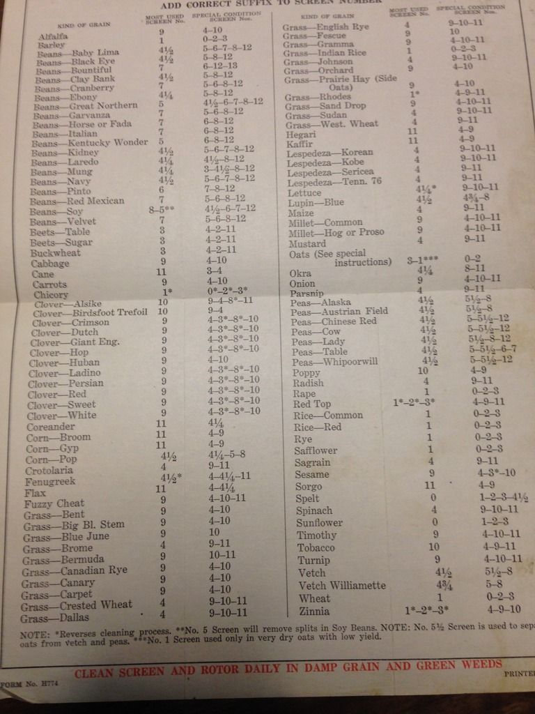

Found this in the bottom of a box full of torn up manuals at the pickneyville show, has the full Crop chart on back. Hope this helps someone, Tom.

     That is a very excellent find. I was there also searching thru the mountains of manuals. Thanks for the post.
