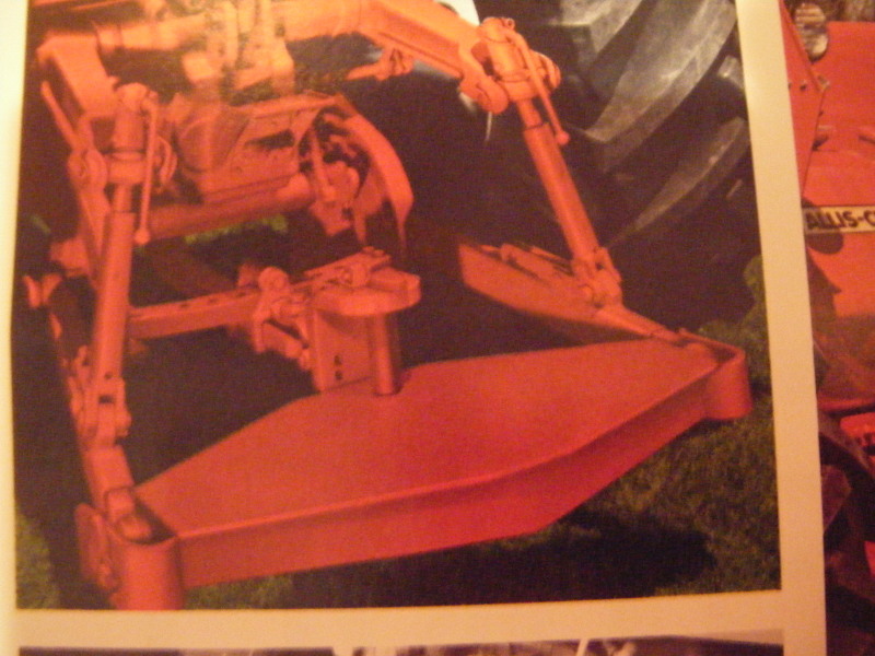

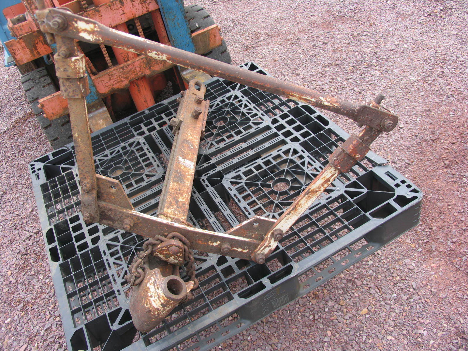

Traction booster does not work with the drawbar unless it is somehow connected to the hydraulic arms. I think some are confusing the tractors equipped with a spring on the snap coupler bell with traction booster. Not all AC tractors had the spring on the snap coupler bell. Actually most did not have the spring.
Here are a couple pictures I found of traction booster drawbars. The snap coupler one is currently for sale on Ebay. Only with one of these hitches installed will the traction booster work, using a drawbar pulled implement, unless you are using an implement that is mounted to the hydraulic arms.
Three point hitch traction booster drawbar
Snap coupler model (which I never knew existed before)

All Traction Booster systems had a "spring" of some kind in them. The snap-coupler design actually used a big coil spring. The 3-point hitches used what is called a "torsion bar" spring. it is a shaft that is anchored to the frame and gets twisted when under a pull allowing the lower draft arms to activate the linkage to the traction booster system. A-C  never used the top link compression like little Fords do. They always used the pulling arms. That way pull-type implements could benefit from the weight transfer system.
