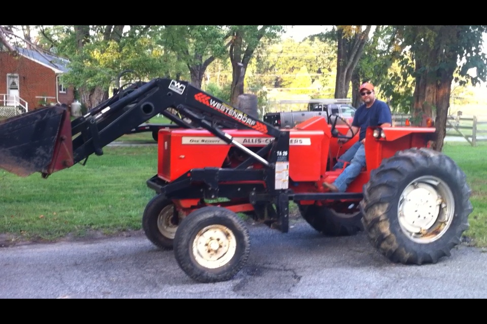

==EDIT==
Adding a pic of my new baby (proud new papa) just off the trailer Saturday - who doesn't like pictures?

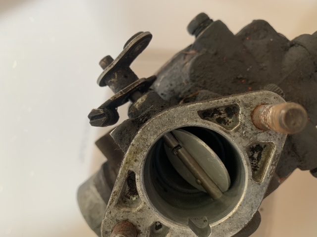

Post Options Post Options   Thanks (0) Thanks(0)   Quote jacasper Quote  Post ReplyReply Direct Link To This Post Posted: 27 Jan 2020 at 12:18pm
I had the exact same issue that Tony described. I took apart the governor and upon inspection everything seemed fine. All the linkage moved properly on both sides of the governor. After some frustration I decided to take the carburetor off and I found that the throttle shaft snapped inside the carburetor. So it would open the butterfly valve but wouldn’t pull it back.
