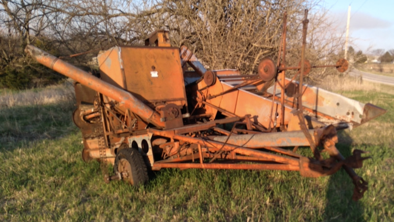

Found an All-Crop 60 that has been pulled up to the side of the road, which I presume means someone is wanting to get rid of it. It's too rough to get it back into working condition but looks to still have most parts. There's a huge rat nest in it.
I see the factory tire size was 6.50-16. I have a used 5.50-16 and 6.00-16 from the front of my WD... Any chance I could get those old tires to fit on these rims to drag it a few miles home? Looks like the bolt pattern is completely different so I can't use new tires on my WD rims, and probably not worth buying new tires just to get this home and stick it in a fence row.
Is it worth dragging home for $100 or less to have around for parts? I don't have an All-Crop yet but wouldn't mind having a nicer one in a few years when I have shed space. am I better off trying to just buy some select parts off of it?

If it’s not too far it’s worth $100, always nice to have spare parts when you need them. A few guards and a pulley and you got your money back.

I would try to get the whole machine. Looks like it’s possibly made during/just after WWII, as the header sides look like they might be aluminum.
I took a 60A that looked about like that and got it operational again, so it’s not necessarily a death sentence when they’re in that shape. Cleaning 30 years of rats’ nests out so the grain drag would turn was the most time consuming part.

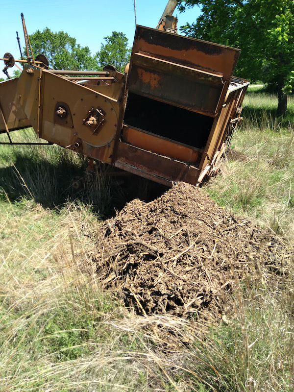

I heard back from the landowner today. Pulled the wheels off of my old JD grain drill and lucked into them fitting the All-Crop, so we made a deal. Man those bolts in the wheel hubs are a pain to keep from spinning when you're trying to break them loose after decades. Got it all swapped out, greased the heck out of the hubs (left side was very sloppy), and made it home at 20 MPH. He had two more that were in even worse shape (one caught on fire) that he had already hauled off for scrap. Wish I'd been able to pull the screens out of them but oh well. He has a few salvaged gearboxes, wheels, discharge hoods, and other parts I am going back for later.
The serial number is 158410 so I believe it's a 1948.

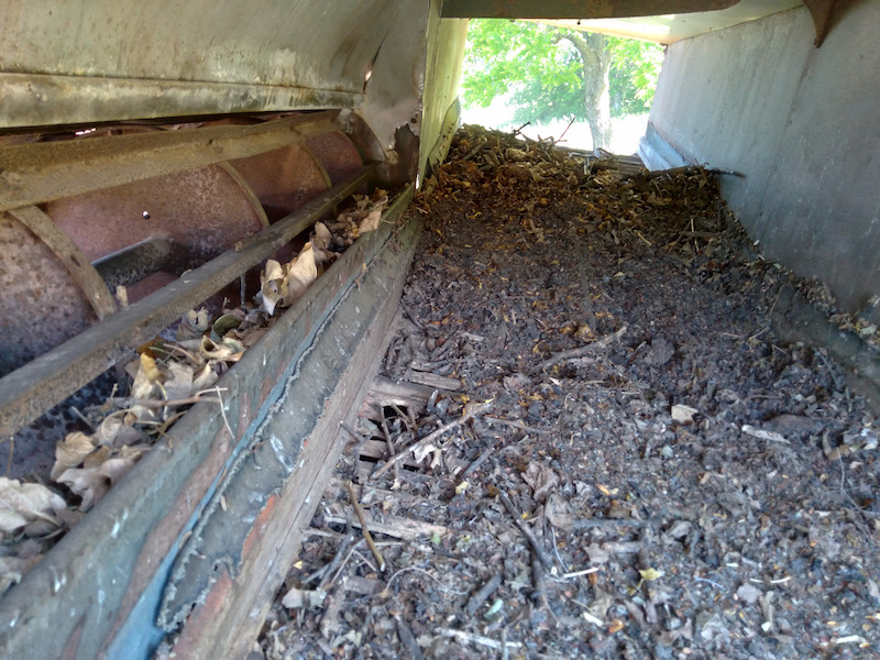

Creston, I too will need to remove a massive rat's nest. I'm hoping the screen can be saved - guessing it's probably wheat? He said they used to do wheat and soybeans with them but didn't remember anything about different screens. This thing is rusted through in so many places it's not worth trying to refurbish, but it should be a good parts machine for that day down the road when I get a nicer one. The pack rats have even chewed the aluminum parts.

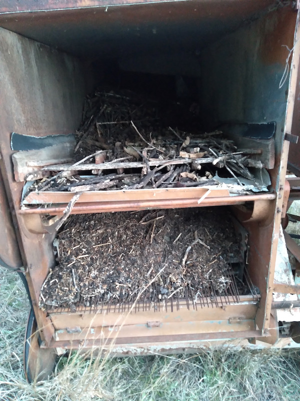

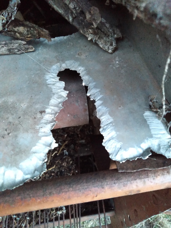

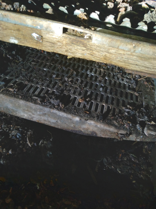

I cleaned out enough of the rat mess to ID the finish screen. So far it looks to be in decent shape. The slots measure 5/32" x 3/4" which I think lines up with it being a wheat/milo screen, from what I've found online? That was probably the most common screen around these parts.

That does look like a wheat/milo screen.
Wow! I’ve never seen rats chew metal like that before. See something new all the time

Thanks for the confirmation on the screen. Yes, that rats here are nuts. I can only guess they were sharpening their teeth?

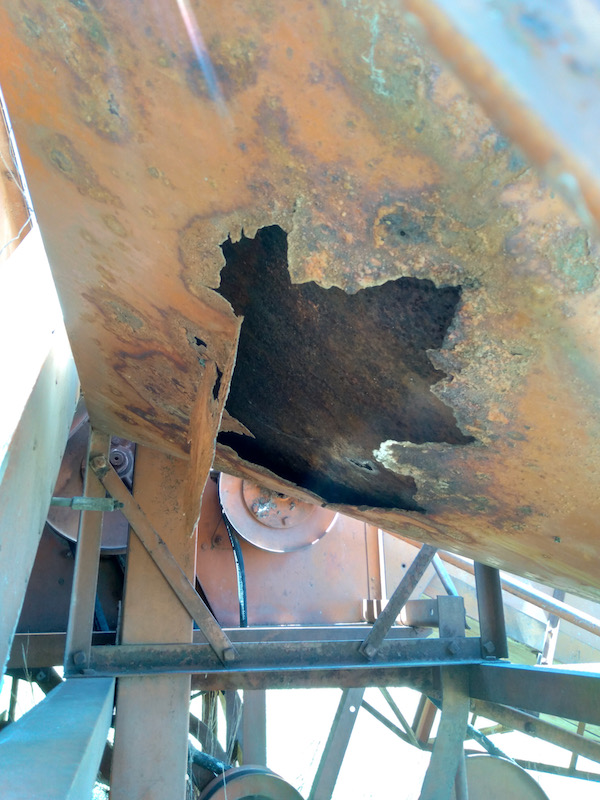

I worked on the rat nest and took a few pictures of the worse of the rust. Don't get me wrong - I'm sure it could be repaired with enough time and money, but for now I'll hold out for a nicer one.

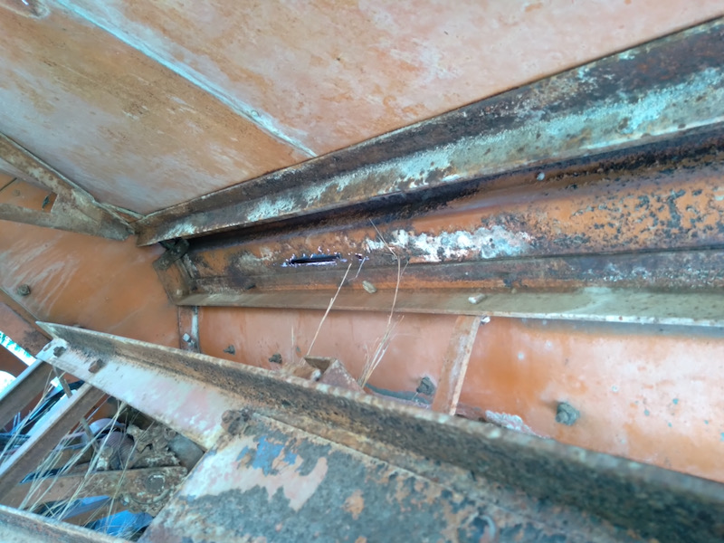

Here's looking up from underneath, where the drapers would bring the crop into the cylinder. You can see daylight:

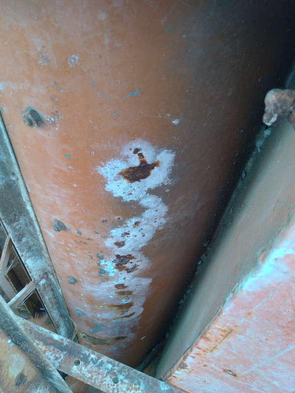

Under the cylinder appears to have not quite rusted through, but I'm guessing those rust spots are pretty thin:

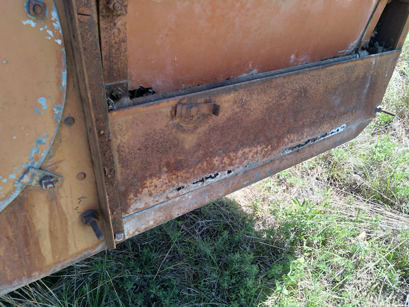

Some rust on the LH side near the rear corner:
The bottom of the bin is disappearing:

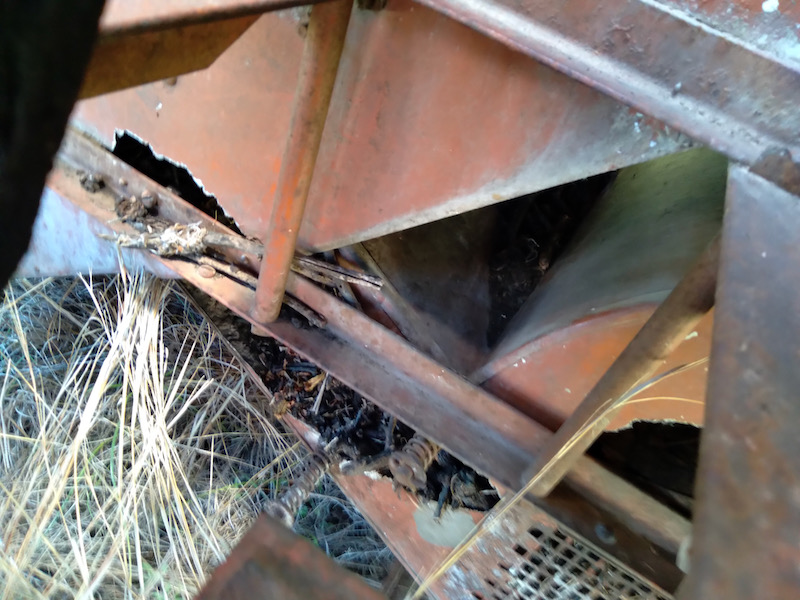

There's also a pretty good hole in the front side of what I think is the air duct from the fan:
Anyways, you get the picture. The fan housing has a dent in it too but I'm sure that could be worked out.

Inside didn't look terrible after I cleaned out the larger stuff with a hoe. Some of the wood pieces would need to be replaced. The rubber is of course gone from the cylinder.

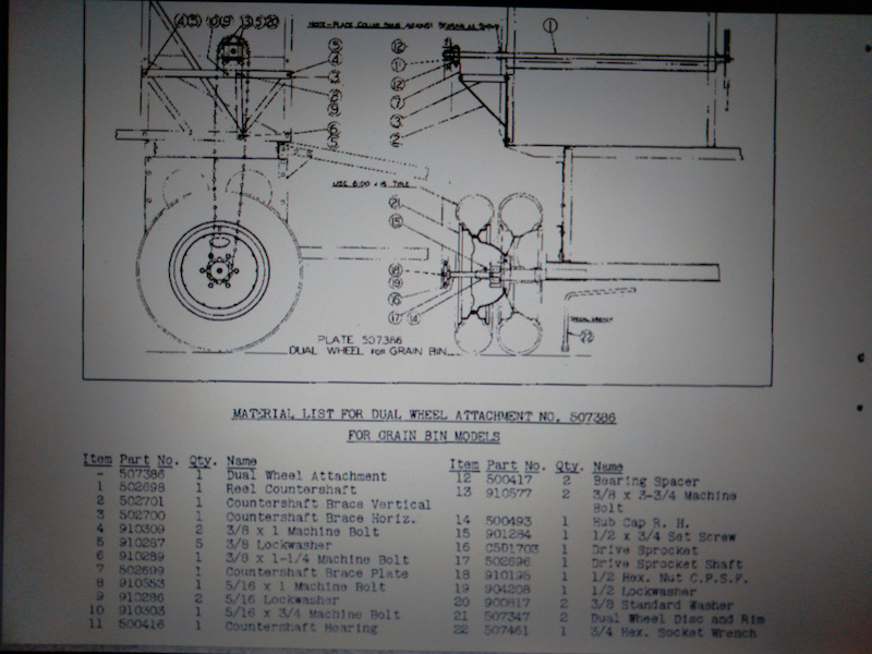

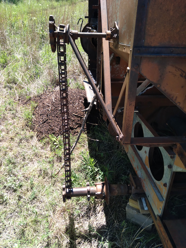

I spent a while trying to figure out what the point of the sprocket sticking way out from the wheel hub was on this machine, as I couldn't find any other All-Crops online like it. I came across the dual wheel attachment kit instructions and parts list in the manual and it clicked.
Looks like it uses 2 15" wheels back to back instead of the normal 16". Most setups I see have either the factory singles, or the tandem wheels so these must not have been too popular?
EDIT: Sure looks like a 15 in the diagram but then says to use 6.00 x 16 tires in the instructions for attaching section later on. The dual rims are unique part numbers, though, so they must just be narrower or have different offset. Standard (non-dual) tire size is 6.50 x 16. The manual calls out a 6 ply for the bin side and a 4 ply for the LH side... That must have saved a farmer a couple of bucks back in the day, since you don't carry as much weight on the LH side.

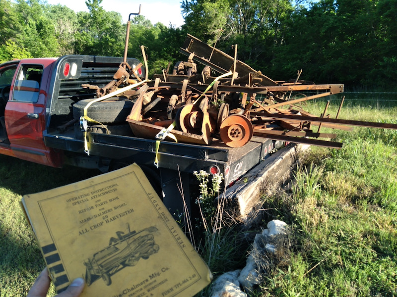

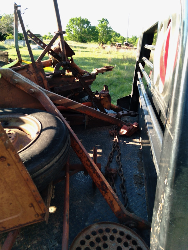

I picked up the rest of the stuff - looks like 2 straw hoods, 2 sets of rims that have had truck rims welded to them for duals, one separate rim, 2 gearboxes, 2 sets of hitches/PTO shafts, some random Snap Coupler parts he found, and some packer wheels I hope to adapt to my JD drill. An original manual even turned up. I suspect it's a little older than this machine but hey, still lots of good info.
