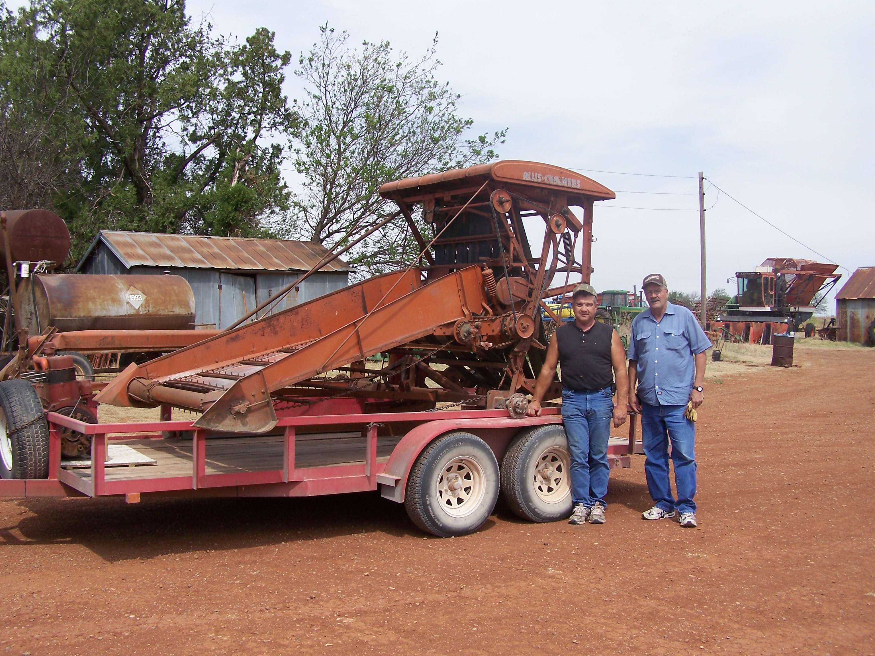

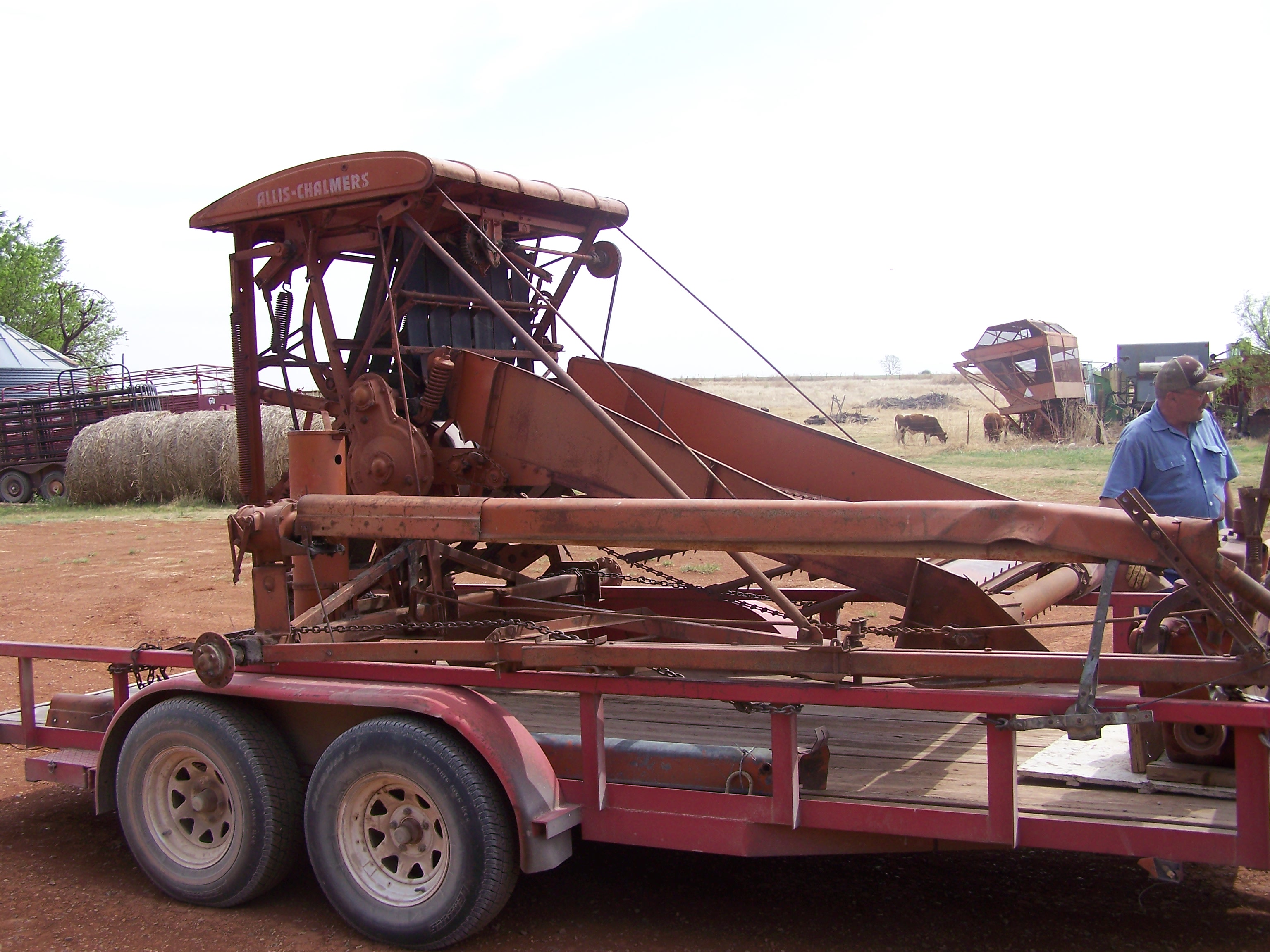

Post Options Post Options   Thanks (0) Thanks(0)   Quote Gary in Texas Quote  Post ReplyReply Direct Link To This Post Posted: 20 May 2017 at 4:05am
Friend and I hauled this one from East Iowa to S.W. Oklahoma.
Gary in Texas
