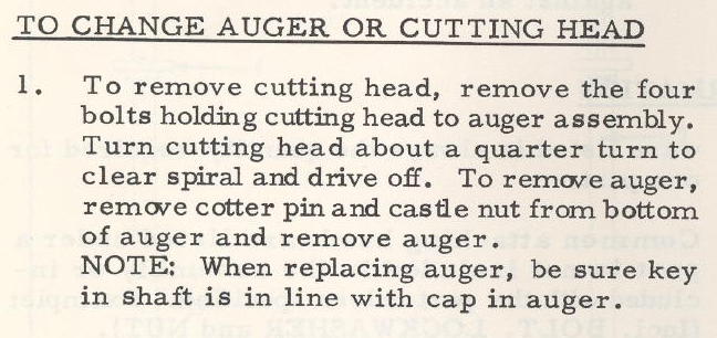

Dave thanks for reply I think this one is just stuck tight. I can see the keyway it looks straight that you can see. I think its time to find big press and see what gives.

Now where was I before I was rudely interrupted by that power outage?  Oh yes, i noticed on the parts lay out that the auger is keyed to the auger shaft.  Sometimes when a shaft turns so long in one direction with that much back pressure, the key "bites" into the side of the key way.  If that is the case, you will break something before you get it off.  Boy, don't ask how I know that ($$$).  If you can see the key way in both the shaft and the part around it, make sure they are perfectly aligned.  On our part, a crankshaft, you could not see that alignment because the key was a woodruff (moon) key.  If you can keep the shaft from moving and hit the auger so that it rotates on the shaft in the reverse direction just a bit, the key will let go of the "bite" mark it made in the side of the key way.  May not be your exact problem, but solved ours.

WF32, Email me at "drichard@ewa.com"  if you need the manual.  It is about 7meg and requires an email account that can accept a file that big.  Other wise i can send you a printed copy or disk.   Dave

Try again the roper shaft goes all the way through the auger and lower bearing is bad, shaft wont turn. Anyone ever have one apart how hard does it come apart do you need it in a big press to get it apart.
