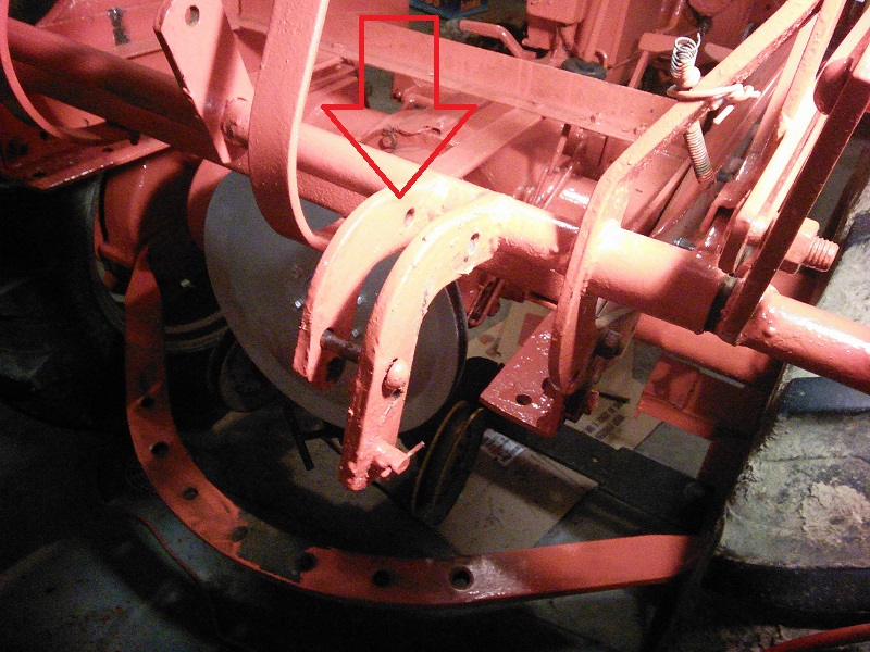

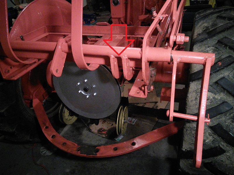

Hi all,
I've got a C with a rockshaft.  I would like to get a 3pt kit from Tony or OKTractor, but before I do I have one question that I was hoping someone on here can answer:
Can I leave my rockshaft on my C and still get the 3pt arms to raise fully without hitting the point on the rockshaft where the hydraulic cylinder mounts to it?  I'm hoping that if I tie off the rockshaft fully raised I'll have sufficient clearance.  I have a Kub Klipper (Sun Master) finish mower that uses the cultivator arms attached to my rockshaft.  If I take the rockshaft off I'll have no way of raising/lowering the mower deck.
For the record, I do realize that I'll have to take the PTO pulley wheel off of my PTO to hook up the 3pt cylinder.
Rockshaft down:
Rockshaft up:

Post Options Post Options   Thanks (0) Thanks(0)   Quote JimD Quote  Post ReplyReply Direct Link To This Post Posted: 23 Apr 2015 at 9:42am
I replied to your email.
JImD
Owner of OKtractor.com PM for an instant response on parts. Open M-F 9-6 Central.
We have new and used parts. 877-378-6543

Post Options Post Options   Thanks (0) Thanks(0)   Quote lagreex1 Quote  Post ReplyReply Direct Link To This Post Posted: 23 Apr 2015 at 8:45pm
Thanks for the email Jim!
For anyone wondering, Jim's answer is "It's close, but I am going to bet that it will have to be removed."
