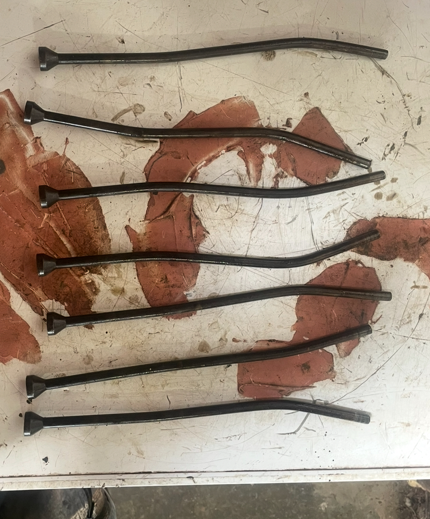

Update: found that all 8 push rods are bent and I call shot…
The rear crank seal leak ended up being the gasket had fell into the oil pan.
Anything else I should check?
I’m going to re-torque everything just to be safe.
What are the common problems that cause pushrod bending? Don’t want it to do it again…

Post Options Post Options   Thanks (0) Thanks(0)   Quote plummerscarin Quote  Post ReplyReply Direct Link To This Post Posted: 21 hours 54 minutes ago at 6:23pm
In my case, the valves hung up in the head. Bent pushrods, bent valves, and left a mark in the piston where they made contact. Might even consider having the rods inspected as well.

Post Options Post Options   Thanks (0) Thanks(0)   Quote steve(ill) Quote  Post ReplyReply Direct Link To This Post Posted: 21 hours 27 minutes ago at 6:50pm
hard to believe that EVERY VALVE was stuck.. but possible... I would check the CAM TIMING... that would effect ALL valves  hitting the pistons.... checking the rods for any BEND would be a good idea.

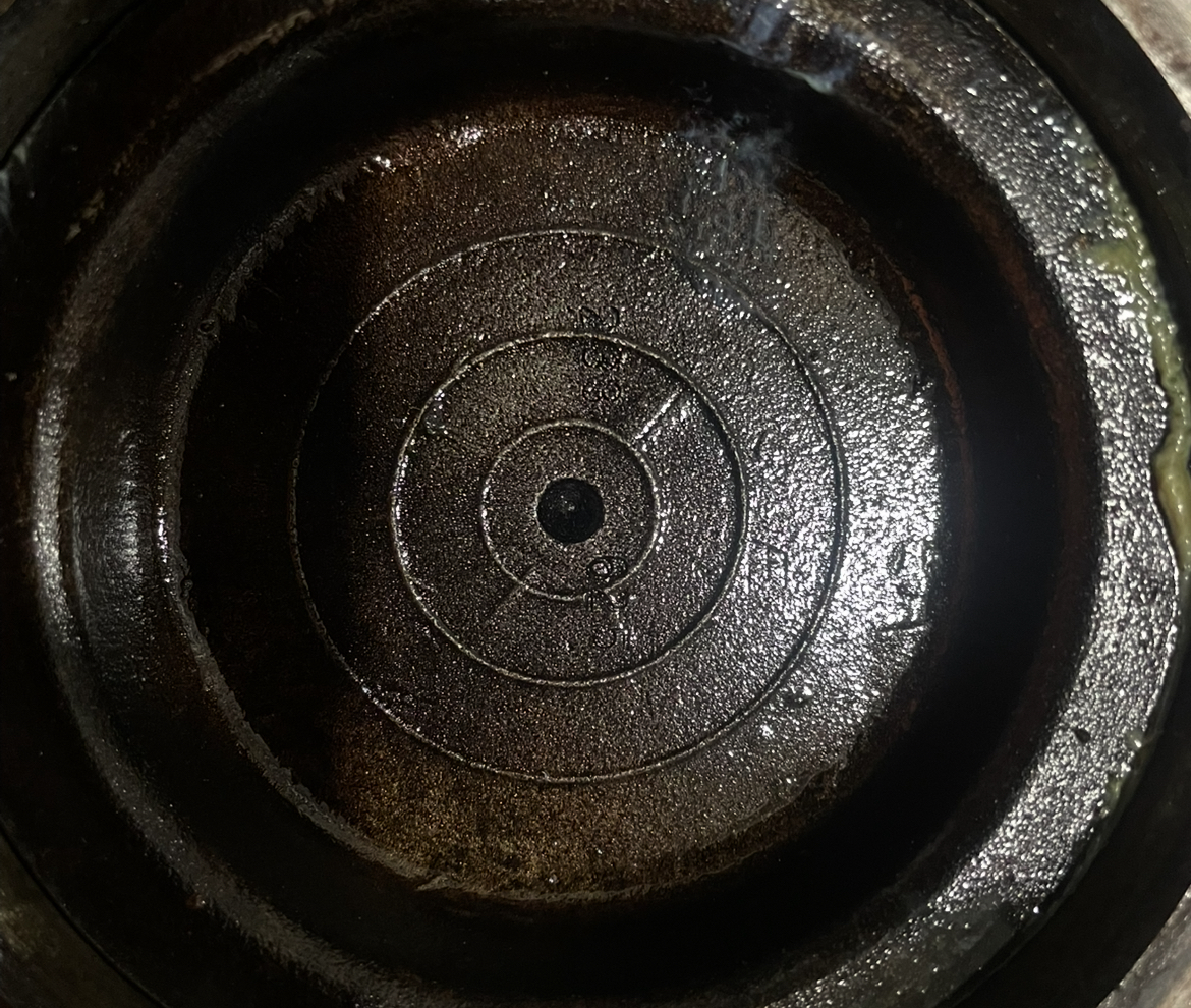

Funny thing is I don’t see any damage to the pistons or valves…
1955 AC WD45 diesel with D262 repower, 1949 AC WD45

Post Options Post Options   Thanks (0) Thanks(0)   Quote 55allis Quote  Post ReplyReply Direct Link To This Post Posted: 18 hours 54 minutes ago at 9:23pm
Found these numbers on on piston; AE 233
Maybe a brand and part number?

Post Options Post Options   Thanks (0) Thanks(0)   Quote SteveM C/IL Quote  Post ReplyReply Direct Link To This Post Posted: 17 hours 14 minutes ago at 11:03pm
Bout have to be cam out of time unless they're all stuck

Post Options Post Options   Thanks (0) Thanks(0)   Quote DrAllis Quote  Post ReplyReply Direct Link To This Post Posted: 9 hours 36 minutes ago at 6:41am
There's something going on with that engine. It was a running engine !! That's why the rear seal was leaking...it RAN !!  All 8 push rods bent on a running engine?? Makes you think the camshaft quit turning.

Post Options Post Options   Thanks (0) Thanks(0)   Quote 55allis Quote  Post ReplyReply Direct Link To This Post Posted: 2 hours 32 minutes ago at 1:45pm
So now I’m even wondering if he ever had it running…
Spark plugs are new and never ran on (he claims put new ones after he ran it)
Pistons still have grease on top.
Crank pulley doesn’t have any paint/rust wore off from the belt.
