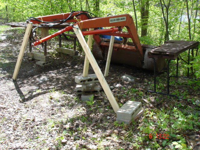

     I thought I'd ask before starting. I have to remove the loader. I am alone and don't have a tree branch available. This loader does not have the swing down arms to hold it while the tractor is backed out. I am wondering about using a 2X6 on each side notched to hold the arms. Thanks, Dave

I have used the rafters in the shop for that purpose. I would expect well supported 2X6s would also work to hold it up; however, you may have difficulty later when trying to re-install the loader (need a means to lift/lower to install the rear pivot pins)

A steel fence post will work fine. Drill a hole so you can put a bolt through the tee post and the bracket on the loader arms. The loader arms are easily lifted when removed so you can adjust height by moving the post closer or farther away from the loader. I have homemade legs for my loader and it only takes about 5 minutes to take the loader of and put it back on. The subframe stays on and the cylinders stay with the loader.

As for removing the loader... the steel-post suggestion works well as long as you have a narrow front... if it's wide, you'll need support over-the-top.  Take a pair of wood landscaping posts, set them on each side of the tractor (just outside the front-wheel track) and lag-bolt a 2x6 across, about a foot above the loader-arms.  Ratchet-strap the arms enough to take weight off the tractor.  As long as the bucket doesn't slide around, the arms will dangle nicely from the 'tree' you've made.  To make sure it really doesn't move, get a big, heavy bucketful of wet dirt or gravel- that'll anchor the front end to the ground.

Well, it is off! I just took my chainsaw, sledge hammer and 2X4's and did it. Not pretty but effective. Ireally only needed the two outside ones which I spalyed out so I could get the wide front out of there. The other two short 2X4's are just for insurance. Tks. for the help.
