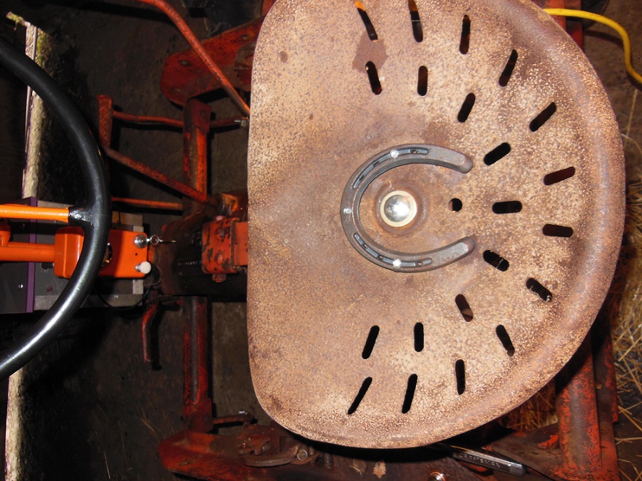

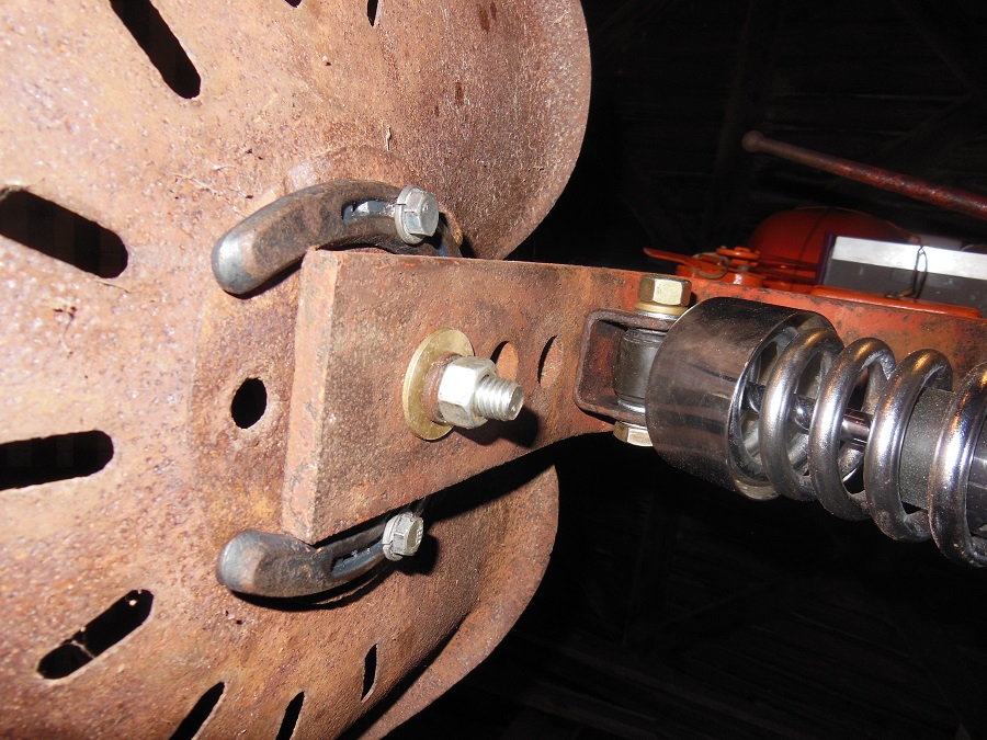

my redneck solution for fixing a cracked seat pan on a CA.  The Harley shock absorber is not an original idea.

Y'all oughter patent that! Fix the seat, and hemorrhoid relief, all in one!Hug

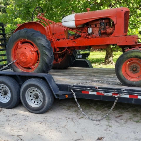

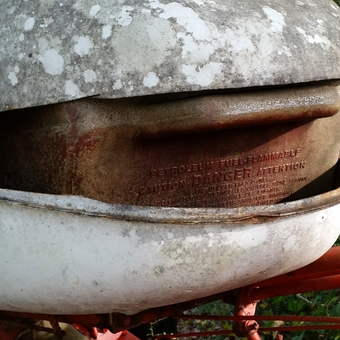

Brought this one home several years ago. See the fuel tank it has a tall filler neck.
Won't work very well though.
Won't work because it has a boat motor fuel tank inside that you could take out LOL!!!
The trouble people go through to cobble something up??

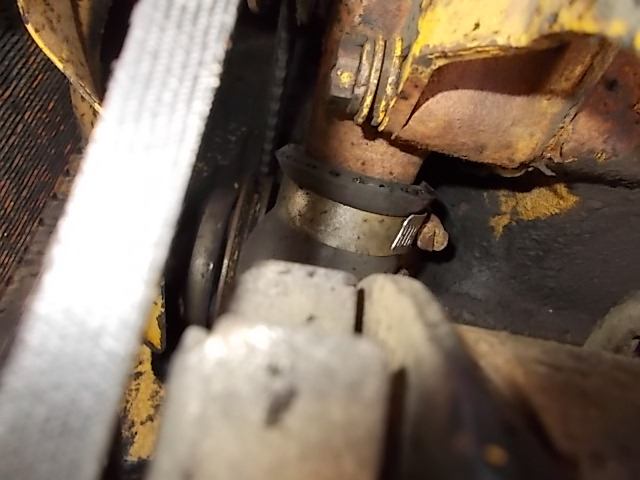

There should be a law that forbids some folks to use tools of any kind. About a year ago I brought an I-40. I knew it had been farmerized as there were springs everywhere on the governor and throttle linkages. I just chalked it up to the typical things of those that can't follow the procedure to properly adjust the governor linkage and thought that it wouldn't be a big deal to straighten that out. I also found that the brake lock had been unhooked, because it it the late style with the ratchet teeth and no matter what you do it won't work as intended. I have a set of peddles from an earlier D10 with the cam lock to fix that.  It had been used for loading mulch and had mulch everywhere. After I got a few layers off I found that the sensing linkage to the 3pt had been disabled. No big deal ther either as I'm going to remove that wimpy bastard to hitch up 3pt for a full Snap-coupler that works with all my equipment.  What really takes the cake is what I've encountered while replacing the waterpump that has a bearing loose enough the the fan was ticking against something.  First off, at some point in it's life the lower water elbow had rusted out as the entire lower hose assembly had been replace with a car hose  and the was no way to drain the anit-freeze into a bucket. Then I see that it is a size larger that the  radiator or waterpump nipples because it is pushed all the way up the neck on the waterpump.
All I can say is that it wasn't leaking and that at least the worms on the hose clamps were pointing so I could get a screwdriver on them.  After getting to the pump itself I find that the last time this was done someone made a stud from all-thread for the bottom bolt. It went in OK I guess, however now the stud needed a lot of help to remove. As the I-40 has a loader and hard nose, I'm not removing the radiator. I got the fan off and out with normal effort, although the waterpump hits the radiator before it clears the stud. The only thing I found to work was vise-grips and that only had room for about 1/8 turn at best. needless to say at 16 threads per inch and the homemade stud in near to 1/2" that took awhile.  The method I do is to remove the pulley on the one with the cast fixed pulley, drop in the correct bolt with copper sealing washer and then press the pulley back on. that allows for removal next time without pulling the radiator.

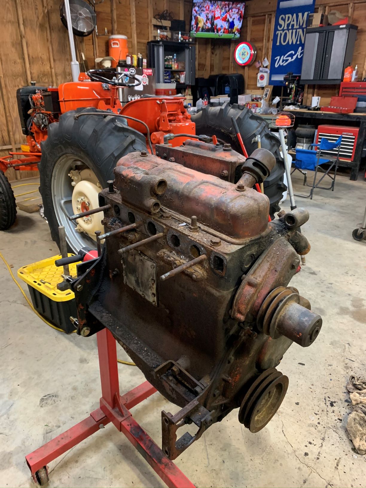

Here is the patch my grandfather put on the block when it cracked. Flat piece of steel with stainless screws and inner tube as the seal.....
