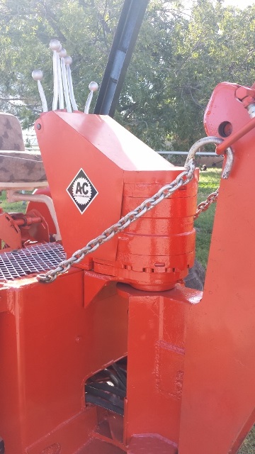

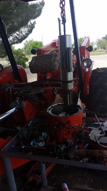

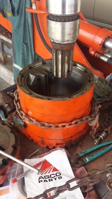

   Well, Guys,,Update # 99,,It has been many enjoyable days, weeks, months,, years gettin this project to this point and I am glad it is finally finished where it can go to work. Gonna load it on the trailer and take it up to the mountain place to do some clean up next week. Still thinkin bout building a bolt-on thumb for it,tho,,,The extra decals and pin stripeing that were on the industrials haven't come in yet so that will be "last job".
 I tried to re-do the piping to delete the selector valve but neither the BH or the loader would operate,,,,HMMmm,,,??? So, I relocated the selector valve where it can be reached from the BH seat as well as the tractor seat,,Works many wonderfuls now,,,,ClapClap
 The rebuild of the Cessna Rotary Swing Cylinder was absolutely the biggest and most stressful job,,,but was well worth all the B,S&T's as it works so well now,,,!!!! OH,,,,one other thing,,,the swing is so forcefull,,you gotta just barely move the lever and it wants to haul azz,,,!!! There are some " 3/16" restriction orifices" in both of the 3/8" hydraulic hoses to the cylinder and I'm thinkin bout machining some new ones with smaller orifices like bout 1/4",,,,??  The Rotary swing cylinder uses 3/8" hoses , where all the other hoses are 1/2". What do the "Hydraulic Gurus" think  bout goin to 1/4" orifices,,???

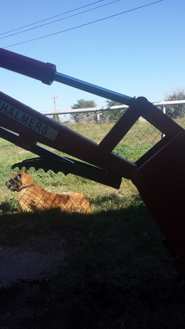

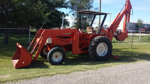

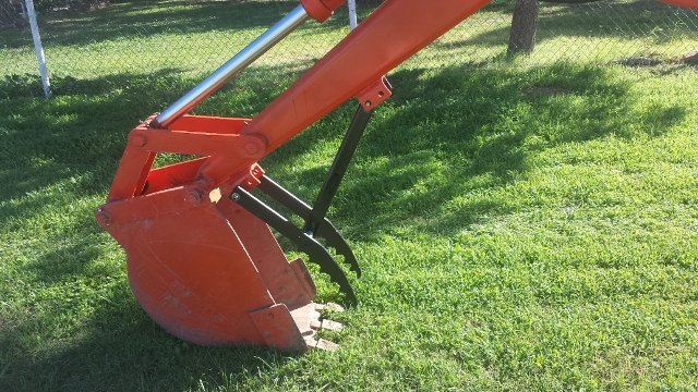

     OK,,,I've reached update #100,,,,,and I think I'm DONE with the "Rebuilding" of this project,,,,,,gosh,,,it has been soooooo long in the makin,,,4, 5 years,,,,Clap time to put this thing to work,,,and go on to my next project,,,,,the completion of the Lambo 55,,,yea,,,yeah,,,Clap
    I built this "thumb" usin ideas from several pics on the 'net and it works many wonderfuls,,, so I'll be able to grab and move them logs at the place up in the mountains.

     CHIT,,,pics didn't load,,,bite yer tongue,,Shameless,,,
  The "teeth" are 1/2" plate, the "main" hold-down is 2"X2"X3/8" square tubing, and the anchor points are 5/8" and 1" machined pins,,should be hell for stout,,,!!!Clap
