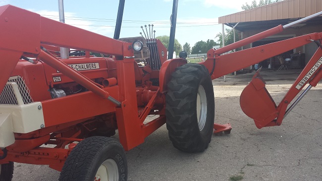

  Well,,Guys,,,,finally got a bit of an update on my LOOOOOONG runnin D14 Industrial Series 3 1/2 project,,,, but the sob does Swing all the way to BOTH directions now,,,!!!!!  Dang,,,!! that right there was one BFJ,,,and took like forever,,took just as long to find the right seals for the cylinder and just as long for the job,,but it is lashed up and operating like it susspossed to,,,Clap
   I know I'm gonna do like ole Shameless and send a letter of complaint to the CEO of  Minn-Par, as they had the friggin parts all the time just wouldn't get off their toolie-waks to get em,,!! BUT,,,they couldn't stop ole Albert from Ziegler Equip. Co,,,! He knew what I needed and got em from Minn-par,,,how bout that,,,???Clap
   I feel a little better now,,,,,Wink

dang Joe! that ole gal looks GOOD! now it's to purdy to use it! whew! that needs to be in someones inside collection! me thunks, you need to build a big building and start collecting!

and.....even tho you drink rot gut beer, you do...do a good job at restoring! congrats!

Looks great but it looks do good you sure you actually want to dig a hole you might scratch it up... you better to find a beater to use... lol. Congrats on a job well done.

Looks great Joe, I'm gonna hafta come down an try it out sometime, we'll hafta have some coffee or beers or somtin, I gots that ferd runnin purty good now, maybe it will makes it down there an back

    Hey THANKS Guys for the nice comments,,,its been a long time gettin here,,and like my Good Buddy says,,,WHEW!!!,Clap  Feel free to come on down, Michael,,we'll take your trk and go cruise Sonic,,,,
    Drove it out from the carport yesterday and gave the hoe a good workout and the swing cylinder works "Many Wonderfuls" ,,,
   If I ever catch up with the idiot that assembled the cylinder wrong to cause me all these headaches,,,,I gonna make him,,,,,,,,,,well,,,I'm gonna make him drink at least 5 Black Labels that been in the garage (HOT) for at least 7 months,,,,,,,Clap That outa teach him,,,,By Golly,,,!!!Wink
   Took a grease gun and hit all the new zerks and,,,,,,,,there is ONE that would NOT take any grease,,and is the big cylinder on the crowd,,,so back in the carport it goes. Gonna try to melt the old grease first, but like all others,,will prolly have to remove and machine a new pin,,,,,THEN,,,I should be able to say " It Done",,,,,Clap
 I did quite a bit of documentation on the disassembly and rebuild of the Cessna Swing Cylinder, with part numbers and am thinkin bout doin a write up for others here. It's not really a complicated process but lots of time could of been saved with a good step by step,,,,,Clap I can't remember which member here called out Albert's phone number with Ziegler Equip, but that guy was a life savior in gettin me the right parts,,so Thanks to him,,,,,ClapClap

NICE LOOKING!!! Big smile
Like Dan73 says, how are you a gonna bring yourself to scratch that nice new paint?
