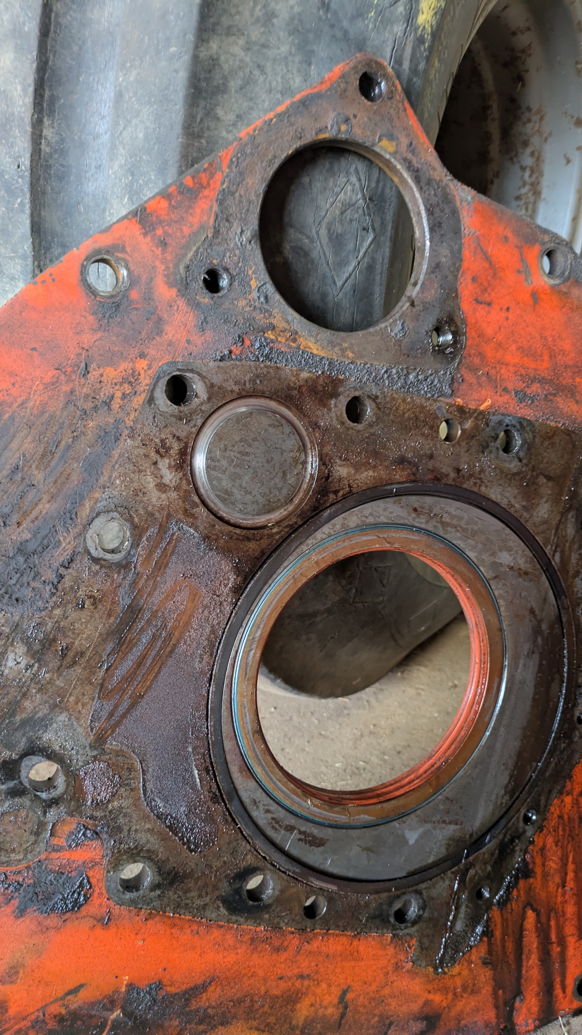

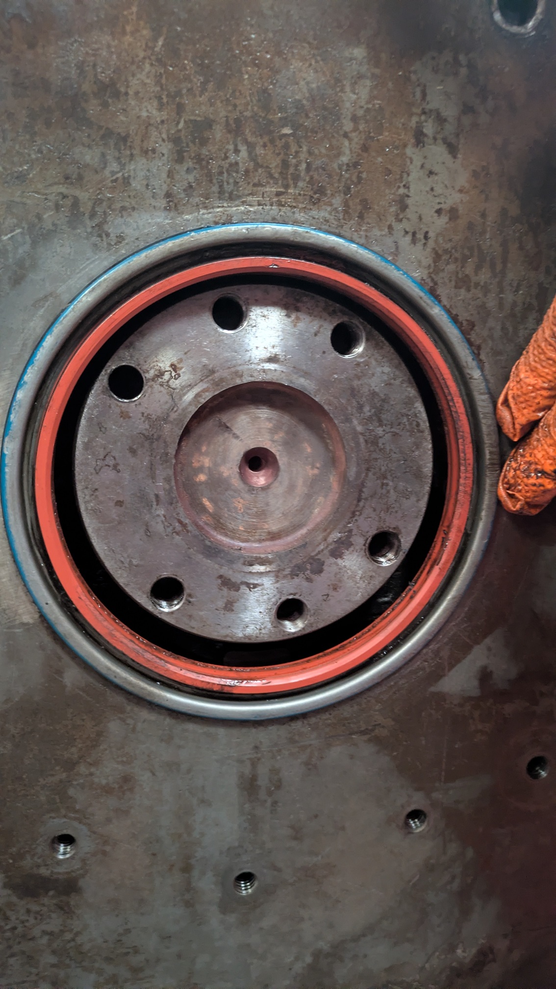

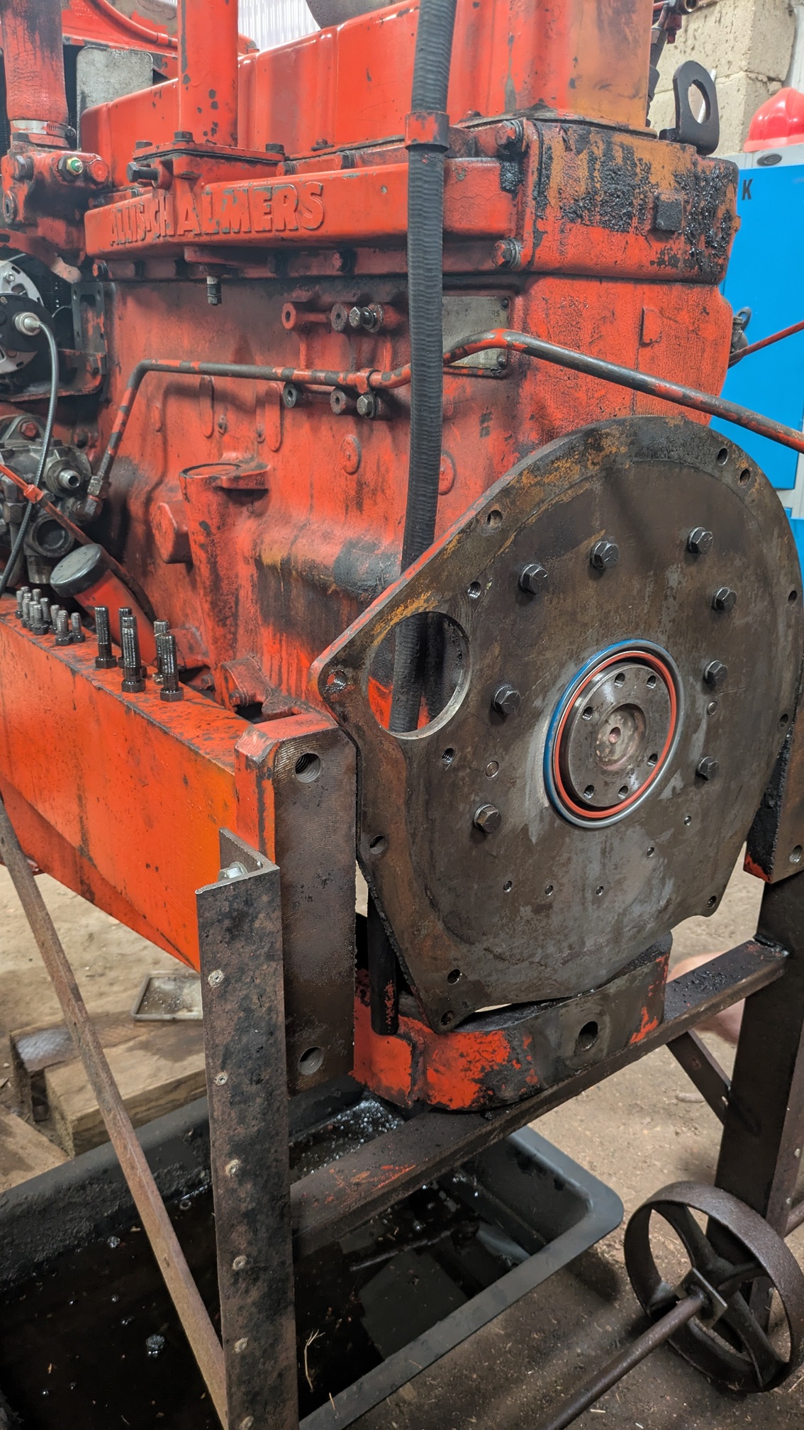

Thanks for the replies. The catch is being in England I'm not sure the AGCO dealers here would be able to help much as these tractors were never sold here but it is worth a shot! I have attached some pictures anyhow.
Was thinking about the clutch, its not excessively worn but tempted to replace it or get it renewed while in there.

That rear seal is installed BACKWARDS !! It should leak  !!!

Post Options Post Options   Thanks (0) Thanks(0)   Quote Meavy_Hetal Quote  Post ReplyReply Direct Link To This Post Posted: 21 Aug 2026 at 6:39am
That isn't going to help then! I'm not to blame I've only had the tractor a year 😅. It came from Canada...

Post Options Post Options   Thanks (0) Thanks(0)   Quote DrAllis Quote  Post ReplyReply Direct Link To This Post Posted: 21 Aug 2026 at 8:02pm
With the rear plate off the engine, no special tool is really needed. Just use a plate large enough OD and press the seal in from the rear until it is flush with the front face of the rear engine plate. Press the wear sleeve on till flush on the flywheel using some sort of loctite to seal it to the flywheel.
