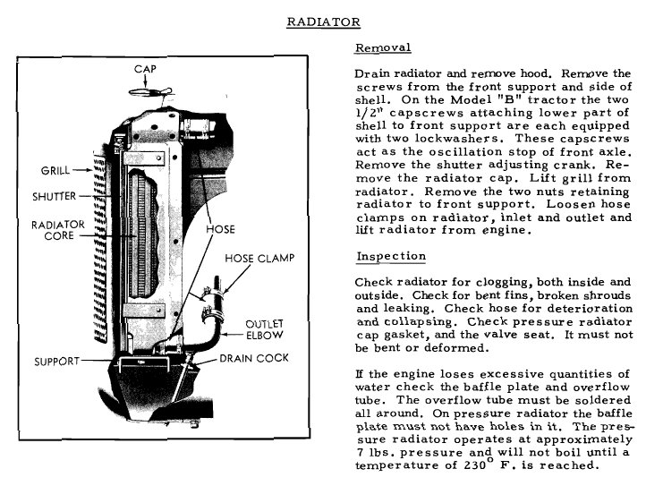

What is the temperature rating of the thermostat? The whole benefit of pressurizing the cooling system is that it raises the boiling point of the coolant. Permanent antifreeze also does that. Is the thermostat turned so the sensing side is towards the engine? Sounds like its slow to open and gets the coolant boiling so it flows really fast, faster than the radiator can take the flow. There needs to be air space in the radiator to allow for coolant expansion and radiator core flow resistance. The shop manual points out a couple other details.
That shop manual is on line at: http://www.geraldj.networkiowa.com/Trees/Allis-Chalmers-G-B-C-CA-Service.pdf
The page on the radiator is:
Gerald J.

Read the last paragraph of the shop manual page I posted above. It says those B and C that are pressurized have a 7 psi cap. Its from a scan of Allis Chalmers form SM-3, I didn't find a date.
Gerald J.
