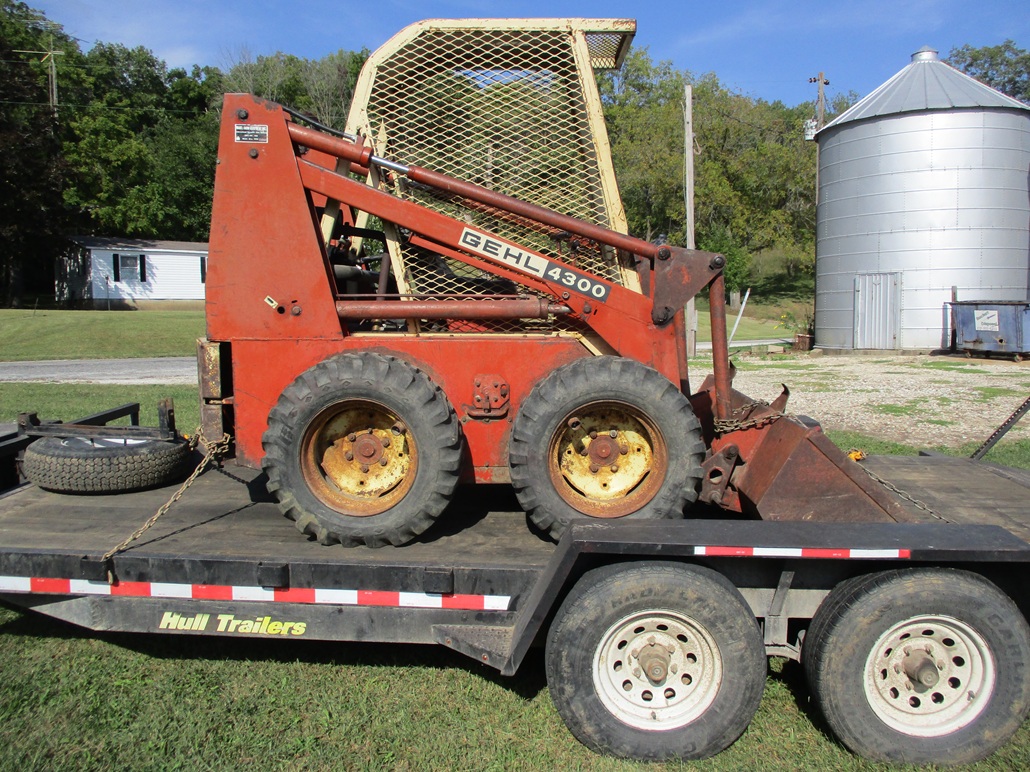

Found a good deal on the GEHL.... Has a 1.3L FORD industrial gas 4 cyl engine... Weight about 3800 pounds.. Lift about 1200 pounds..  Good shape, but not to pretty....Now to get some FORKS !

For our farm, if I could do evening I need to with a skid steer I wouldn't even own a tractor. I absolutely love them. But I don't have the snow issue that a lot of you guys do. That's a cute little Gehl. About the size of a Case 1830 I guess? I don't think you'll have to spend a terrible amount on forks to get a set that can handle 1200 lbs.

Sweet! Big smile

yea, the QA sounds like a good idea , long term.. Problem i have is the BUCKET was not designed wit this in mind.. Photo above shows the bucket mounting brackets are U shaped and wrap around the back side... The QA needs a FLAT PLATE on the brakets and a FLAT PLACE on the bucket back side... I can do that with some fancy welding, but going to take a little work to accomplish... after the PLATE is installed, the forks should be an easier ukpgrade.

Get a skidloader QA plate or a bucket with a QA setup, and make a wooden template to fit the QA you end up with.  Use that template to make the male piece for your loader.  That's what I did, only I use the template to make the bucket (think female) brackets to weld to various attachments, for my ASV RC-30...Wink
