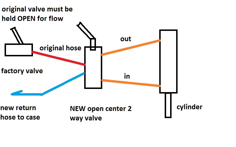

If the D17 has a transport valve you're almost there. The transport valve has a pressure and return line.
Get yourself a 2-way hydraulic valce wiht about 2000PSI relief. Feed it from the standard remote. Put a T into the return line and plump that into the valve return.
A D17 has a high pressure (3000PSI+) low volume system. So this setup will get you 2 way hydraulics, buy they will be much slower than a standard low pressure high volume tractor.

your NEW hydraulic valve should be OPEN CENTER so that the pump can recirc back to the tank ( case ) when not feeding the cylinder UP or DOWN...
Dave, i assume you put your FACTORY valve held OPEN position and feed constant flow to your NEW valve, and use it only ?   something like this ?

Thats how I have it Steve. The  hydraulic lever on the quadrant would need to be up all the time to keep supplying oil to the new valve.
My "New valve" is actually an original Allis valve off an old d17 wiht this option.
My setup will be like original, but an aftermarket open center center valve would be the same.
