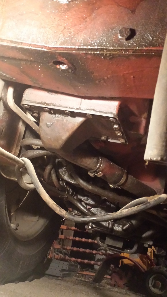

Ok, thank you for the quick responses. I appreciate the knowledge you are willing to share.

What you have is an update from a newer 7060,called a sewer pipe system. There is one drain plug underneath the transmission (above the rubber hose) that takes an 1 1/8" wrench, and one of the four 3/8" bolts at the bottom has a special flat washer on it and is the lower drain. To access the screen for cleaning you need to remove that sump and cover plate. Use good adhesive on both sides of both gaskets and let cure before refilling with oil.

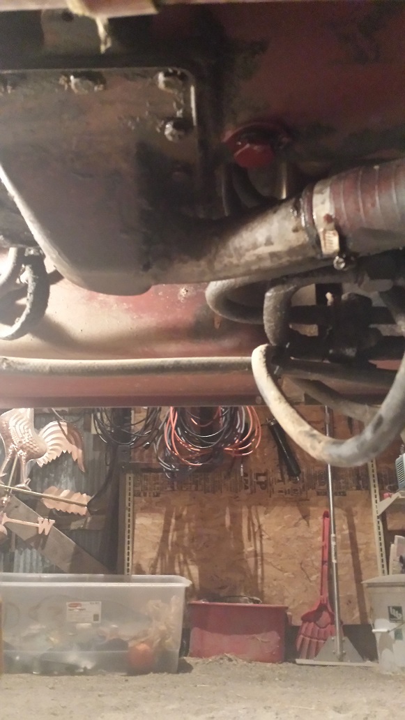

There is the front plug which you have in your picture then there is a back plug below the right rear axle.
Also there is ~2 gallons of fluid in the PTO gear cavity above the rear cover plate as well that does not have a drain plug to get it out.
For that I would recomend drilling a ~1/4" hole about 2" in from the rear and left side of that rear plate to drain that then drill and tap the hole to put a 1/8" or 1/4" pipe plug in it.
