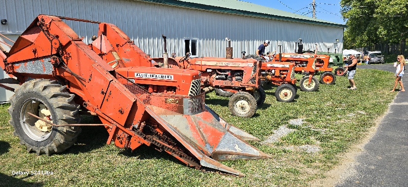

Never seen a D series tractor with side curtains..

The tractors in the picture with the mounted corn picker- they don't have any side curtains
