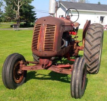

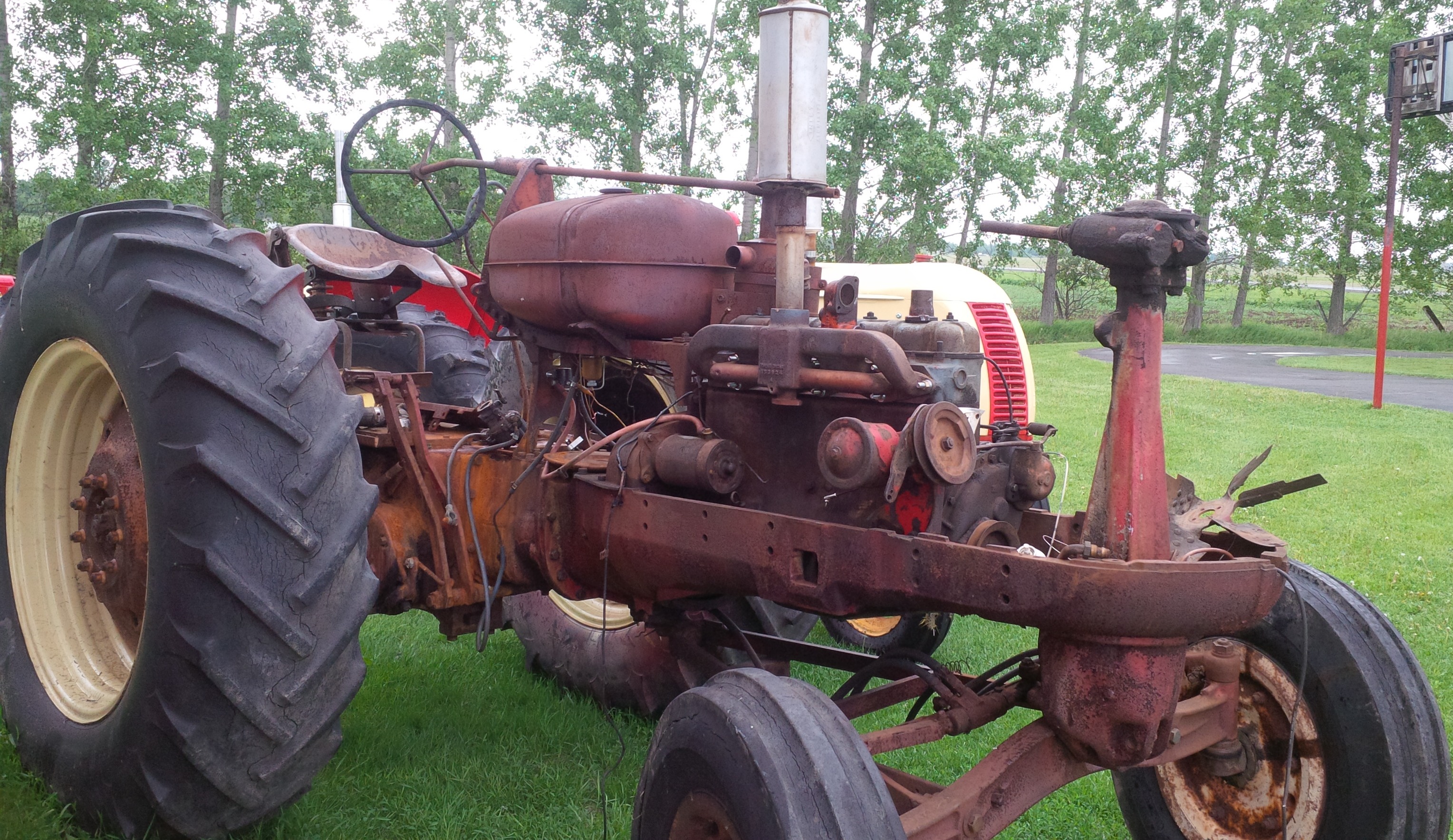

I have taken over a basket case Cockshutt 50 with the Buda 273 engine. I am looking at what I hope is a g262 Allis Engine. I think it may have 2 oil filters on it. Is it possible to be a 262 with 2 oil filters or does that automatically make it a G230? It is a Gleaner engine I am told.
The Cockshutt 40 I repaired last year is now running well. I love the sound of those Buda Allis 6 cylinders!!

Post a shot of the left side please.The core plugs on the right side are not used in the Allis engines.
Posted By: Ngrant
Date Posted: 12 Nov 2014 at 8:07pm
Don, that is original 273 engine in it. It needs a repair sleeve. The Allis Gleaner engine I have not got it home yet. If it is a 262, I will use it as is. If not, I will use the crankshaft plus other parts.

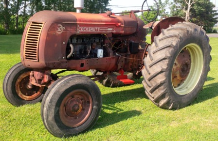

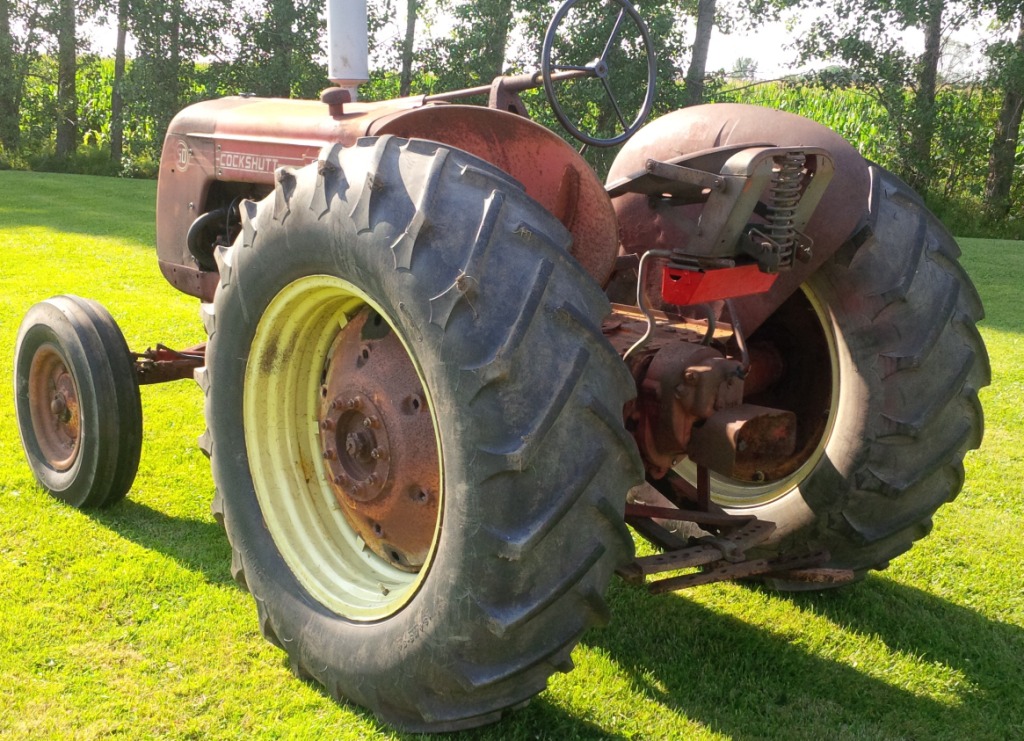

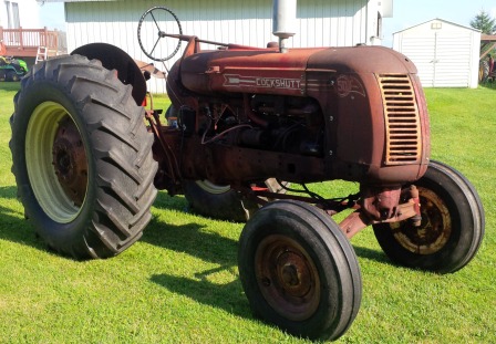

Here is a picture of the 40 complete and the 35L I have also.

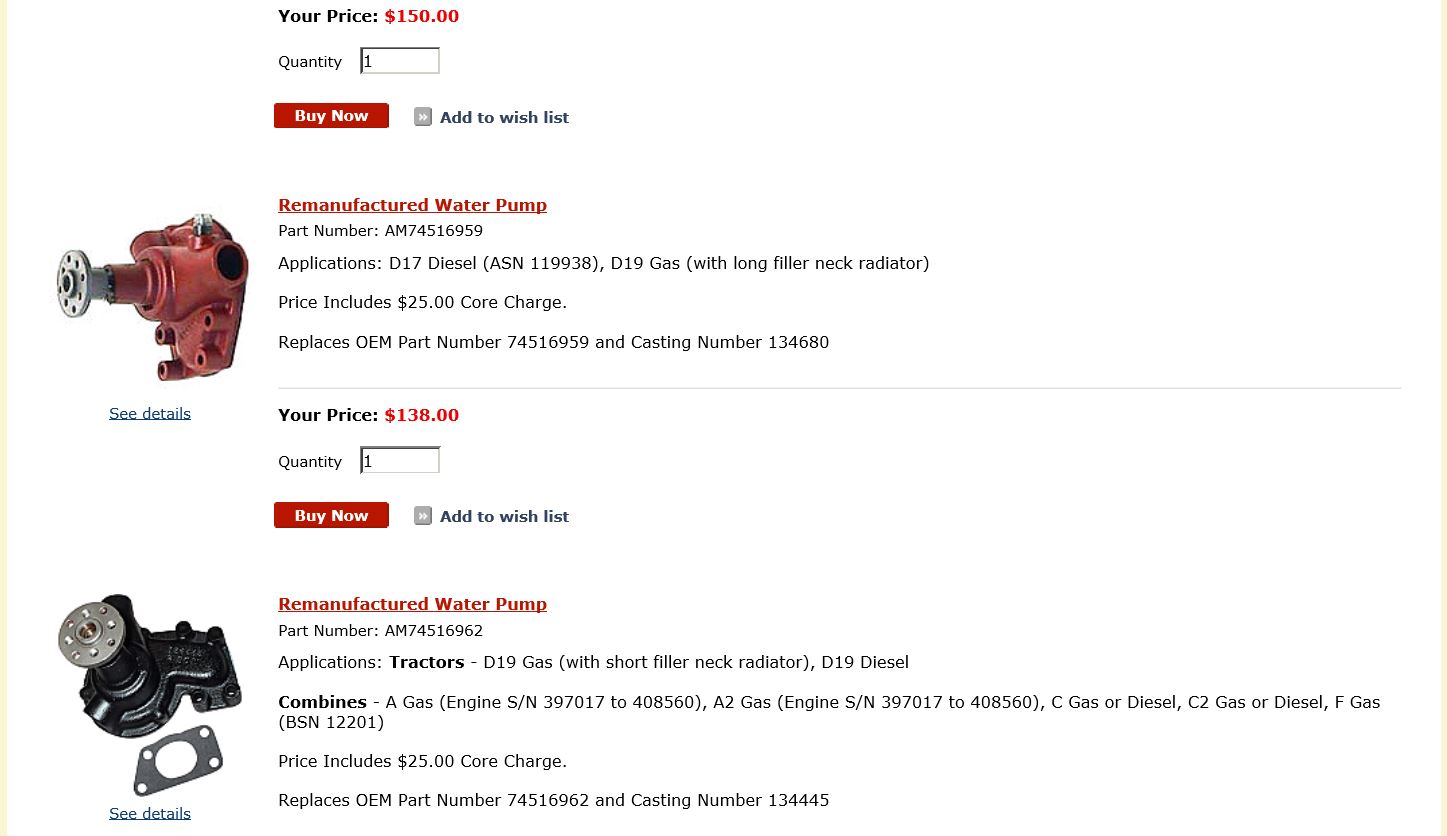

You may need to get a water pump for a D-17 diesel. The fan will be a lot lower.
Been there done that.
Posted By: Ngrant
Date Posted: 29 Nov 2014 at 1:32pm
Would that be the late D17 Diesel? The early one was in the head same as the cockshutt one which there in no provision for on this engine. I am still wondering if there are any distinguishing features other than the big carburetor which determines this is a 262 and not a 230?
Regards
Neil
Posted By: Ngrant
Date Posted: 29 Nov 2014 at 1:50pm
Regards
Neil
I think I may be understanding the water pump now. Looks like I need the first water pump and the second one I what I have now?
Posted By: Fields
Date Posted: 29 Nov 2014 at 10:10pm
It went on easy. No heat.
Posted By: Calvin Schmidt
Date Posted: 30 Nov 2014 at 7:09am
Yes the water pump you likely need is for a late D-17 diesel (Series III or IV) with the waterpump in the block. My mechanic just finished installing a late engine into a series I D-17D. We used a Gleaner 262 block and ran into the high fan water pump problem with the combine water pump. Years ago I had the wrong water pump sent for my D-17 IV diesel resulting in the same problem.

A little update on the progress. The 262 is in the tractor now with the clutch and bell housing all buttoned up. I need to start it before I go much further. When I had the oil pan off and the cam out, I checked a rod and main bearing and they looked very good. I also check the lifters for any broken ones and they seemed good also. The Cockshutt front and rear are in place as well as the new older style D19 water pump which puts the fan a bit lower. It seems the bypass tube is a different size on the new pump - like one size larger than the old one. So I am wondering what model of tractor or combine would be the same and if I got a used bypass and thermostat housing from that model for the bigger line would it all marry up and fit? Any ideas?
Thanks
Neil

I took the D71 Series III diesel water pump to a machine shop and had the hub pressed of an reversed to the same offset as the Cockshutt pump. I then cut the hub and shaft off that was sticking out and would hit the radiator. The Gleaner pump is away bigger than the Cockshutt one. Should keep it cool with the 6 blade Cockshutt fan. http://https://www.facebook.com/neil.grant.549/videos/vb.563709913/10153237115249914/?type=3&theater" rel="nofollow - https://www.facebook.com/neil.grant.549/videos/vb.563709913/10153237115249914/?type=3&theater
Thanks again Don and everyone have a good evening.

The 50 is all in one big assy now. I set the valves per a D19 gas at 17 and 22 cold and then put on the sheet metal. I changed the part under the gas tanks to the less rusted one I got from Molly Bradley and it now has the Allis B series manifold I got from Don Bradely and the thermostat housing and bypass I got from Tom Lunn - Don and Tom two good Allis people and Molly is a good Cockshutt person!
Parts from Minneapolis, Missiourri and Southern Ont all working together with a Gleaner engine from Lonnie Wiggins from Quebec. Feels great to see it all come together. I should have it ready for paint very soon. It is running very well except for a little noise around the governor. Hopefully as the Cockshutt Buda governor gear wears in to the Gleaner Allis engine, it subsides.
Power steering works well. It is the 4th Cockshutt to have power steering ever.
Have a good one to you all.
