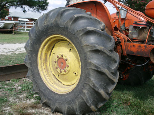

Posted By: Dexter Peabody
Date Posted: 27 Aug 2012 at 10:27pm
Here she is, the WD with the questionable serial number and pedigree.
NOW, I don't know a lot, but if someone was attempting to pull a serial number scam on someone, to make this a more valuable WD, I doubt, that they would bolt that tool box, or, wooden beer ice chest onto the side of it, put a special homemade thermos jug holder on the left fender, make an angle iron doo-dad contraption for the front end, and weld a back rest contraption to the back of the seat.  Just my opinion.
Smile
NOTE!  the REAR WHEELS are painted YELLOW
Thermos holder is round aluminum doo-dad on left fender.   Snazzy back rest, welded to seat.
What is this number and markings on the gear shift, engine side?
The rear, where it says "WD10" then there is the etched out, block beside it
ENGINE # behind car on left side.
   SO, what year WD is it?  I want to know before I put it on Craigslist, and, maybe, this site.  I don't want to mislead anyone.  Need you all's help.  Thanks

Posted By: Don(MO)
Date Posted: 28 Aug 2012 at 6:28am
It's a 1951 or 1952 engine baced on the first two numbers of the six line of numbers on the block. and yes the ser# on the block and ear end of the tractor have been worked over.
Posted By: KGood
Date Posted: 28 Aug 2012 at 6:37am
I don't know how your going to tell the year. It would be interesting to know why it's like that. Not a bad looking unit either even has wide front.
