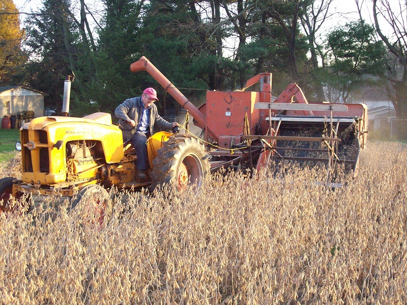

Posted By: jeffrey
Date Posted: 27 Jan 2012 at 3:32pm
Posted By: Regie
Date Posted: 27 Jan 2012 at 4:35pm
Jeffery, great picture, Nice day here but my back has decided it does no0t like me.  I managed to get the stalls cleaned and spent some time looking at the combine.   There is sprocket about half way between the right wheel and the one on the bin, I'm not sure what it's for.  It does not drive anything.  If it is to tension the chain then I'm not sure how it works.  My other idea is that it left over from the conversion form bagging to bin.
