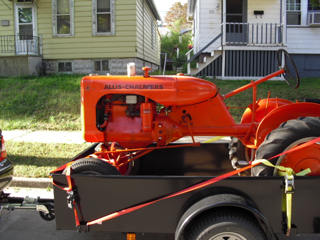

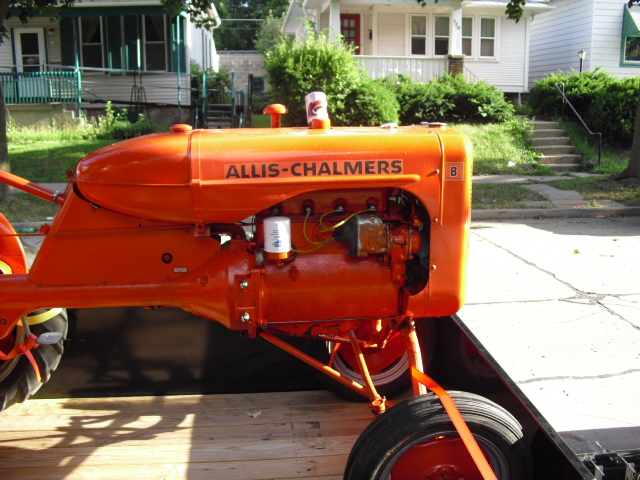

Date Posted: 17 Aug 2011 at 8:26am
Posted By: waynem
Date Posted: 17 Aug 2011 at 8:27am
I will get better pictures later I am taking it to work to show off. I will also figure out posting pictures better.
Posted By: waynem
Date Posted: 17 Aug 2011 at 8:30am
Posted By: waynem
Date Posted: 17 Aug 2011 at 8:34am
Posted By: Ken in Texas
Date Posted: 17 Aug 2011 at 4:31pm
A little hard to see everything I need to see to date every detail but it looks like a 38/39/40 combo. I like that 37/early38 Zenith fuel cutoff jar type sediment bowl.  The speck plate manifold is a correct for the age original. The early B covered spoke steering wheel is nice and correct.
   She is a cutie.

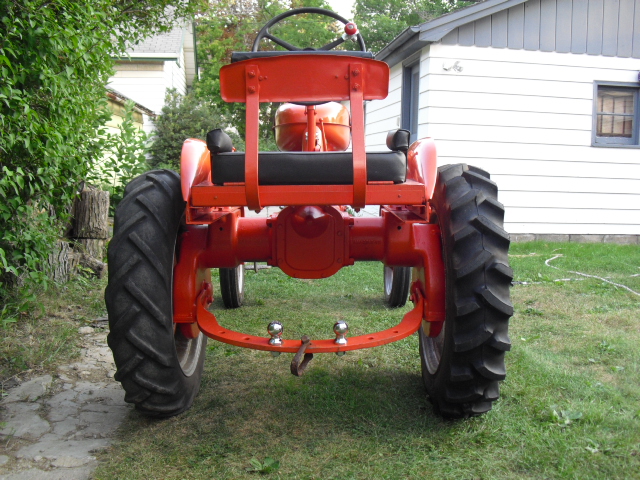

A good shot from the rear will tell me if the seat back support straps  are 38 or 39 and up. 38s are wider than standard.
    Curious to see what vintage the wheels and wheel clamps are.

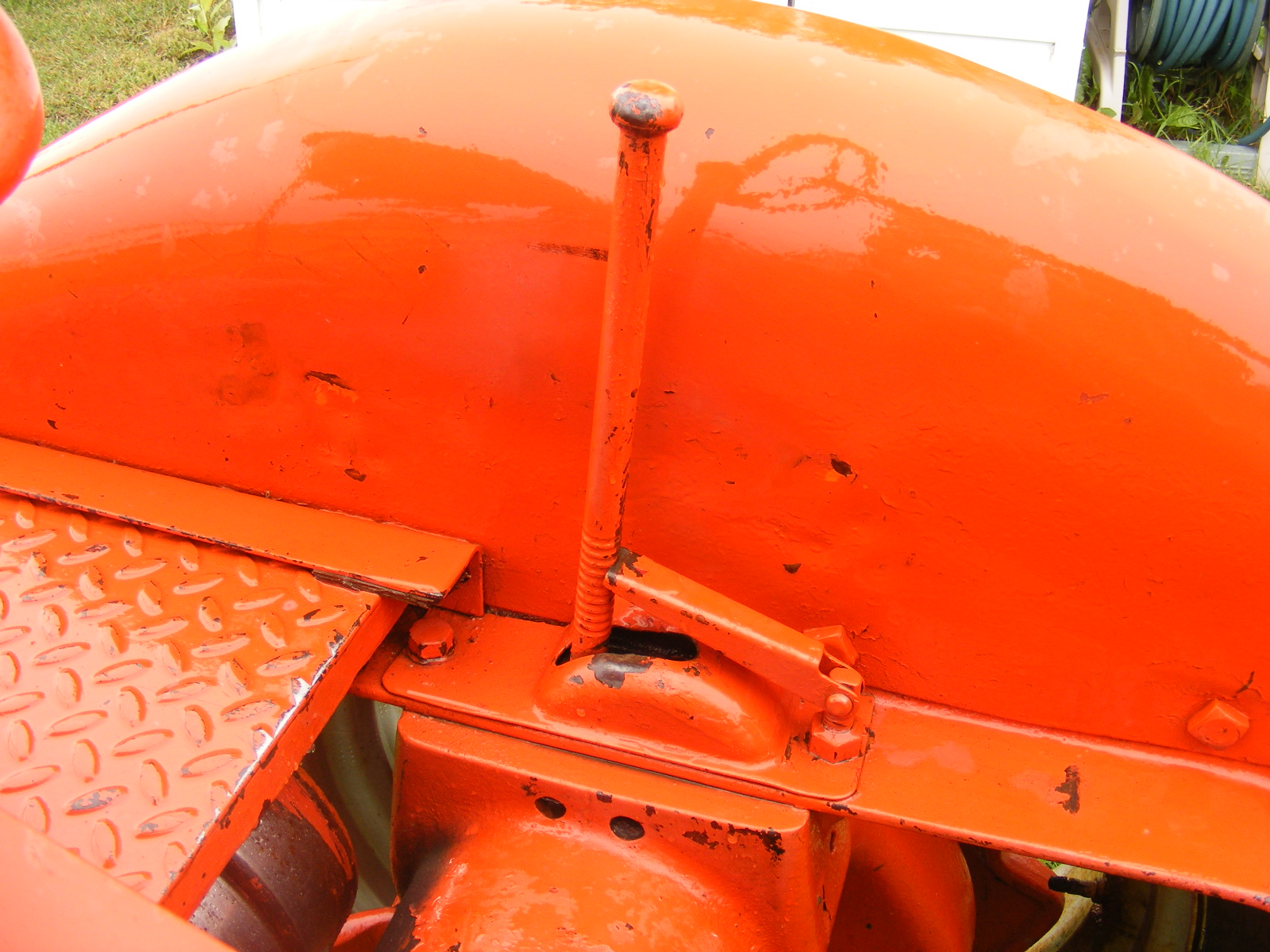

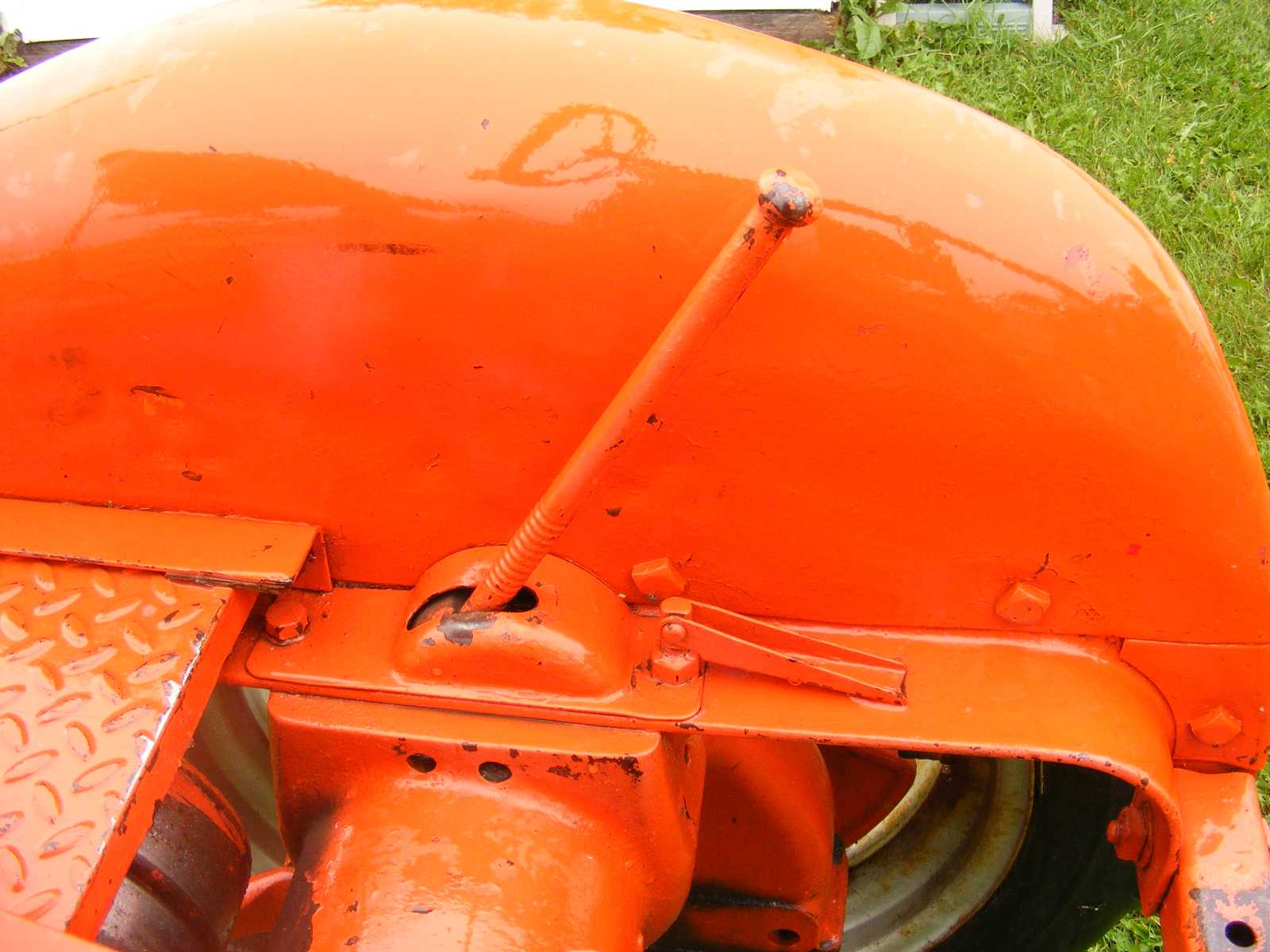

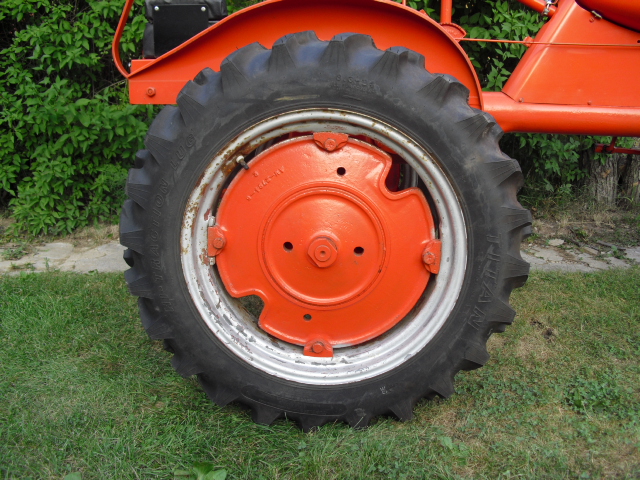

Posted By: waynem
Date Posted: 17 Aug 2011 at 7:02pm
Posted By: waynem
Date Posted: 17 Aug 2011 at 7:03pm
Posted By: waynem
Date Posted: 17 Aug 2011 at 7:05pm
Everyone thanks for the input I am learning alot. I am running an underhood muffler.
Date Posted: 17 Aug 2011 at 9:22pm
Well,  the rear wheels, clamps and rims are not of the two early types used on early handcrank Bs. This clamp and 4 bump rim system became standard sometime in 1940 productiom along with the 5 hole bolt on wheel front wheels.  The seat back supports are the standard 39 and up narrow ones.
   When you restore a B and need a replacement part, pretty near everything from any year B and some C parts will interchange by bolting in or on.  Main thing is get it to run and drive. Call it a 40 if you want but overall it looks more like my 39s  than any 40s I have.  Have fun with it and be careful when cranking.
