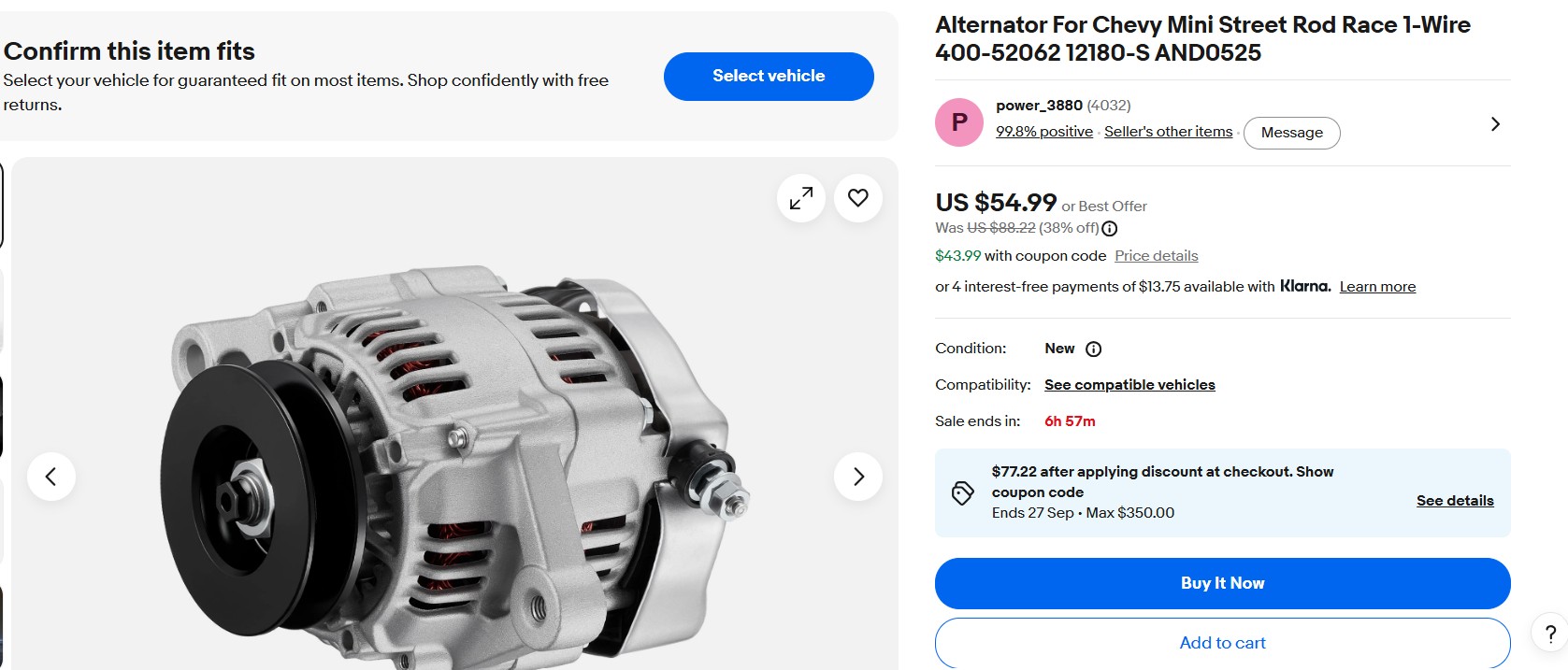

The old standard is the DELCO 10SI with internal regulator..
If you want one about 2/3 that size, you get the DENSO type, or "chevy mini".... prices range from $75. up to about $150. ............ this is on ebay... everyone sells these.
