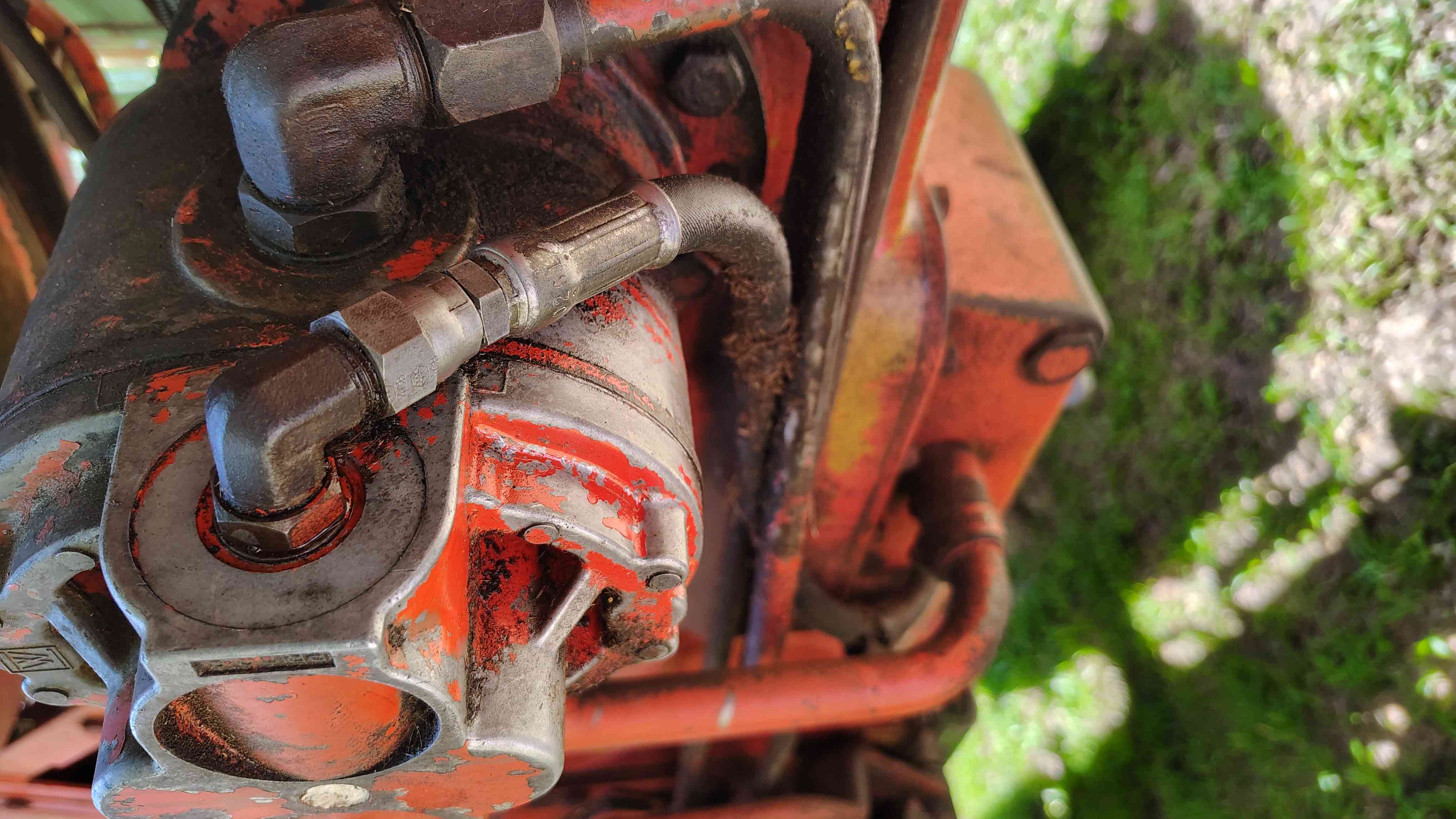

Have a leak at front hose. Leak is where hex head screws into pump housing. Is there an o-ring behind there that could be replaced? Thanks for any info.

Yes O Ring

Thanks. Thought that might be the case. Would you happen to know the o-ring size?

it is a standard O-Ring Boss (ORB) to roll on that fitting. It also must be of a hardness to withstand 2400 PSI of pressure. A cheap hardware store Oring will generally be too soft and blow out quickly. Take the fitting to ANY farm implement dealership and they can fix you up. It is not metric.
