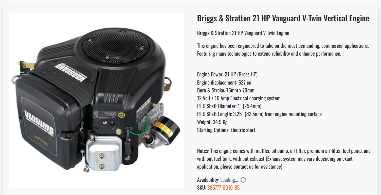

Dave... you can find the shaft dia and length on line.. I assume you have the old 18 HP opposed 180 degree twin.. The came in a vertical and horizontal option... The newer engines are the same, both options...(Remember, some of the HORIZONTAL shaft engines have a shaft sticking out both ends for the DRIVE on one end and the PTO / mower belt on the other...) They also advertise the shaft diameter and length.. I have found most are comparable, as long as you dont try to put a 25 HP motor in a 18 HP tractor..... Jus compare what you have now to the new.. I know you want a YES- NO answer, but some of this depends on what engine you chooses..
this is what GOOGLE says.........
Briggs & Stratton 18HP Opposed Twin Engine Crankshaft Specs
422707 model often faces engine replacement challenges and crankshaft compatibility issues during upgrades.
The Briggs & Stratton 18HP opposed twin engine (model 422707) typically has a crankshaft diameter of 1 inch and a length around 3.5 inches. When replacing the engine, matching these dimensions is crucial for proper fitment with the mower deck and transmission. Measure the existing crankshaft carefully, including keyway size and position. Also, verify mounting bolt patterns to ensure compatibility. Proper alignment prevents premature wear and ensures smooth operation after replacement.
Posted By: steve(ill)
Date Posted: 06 Mar 2026 at 11:57pm
NOTE the SPEC ... gives shaft size...
the new engines will all be overhead cam and have oil filters .. both improvements over the old 160 18 HP opposed twins.

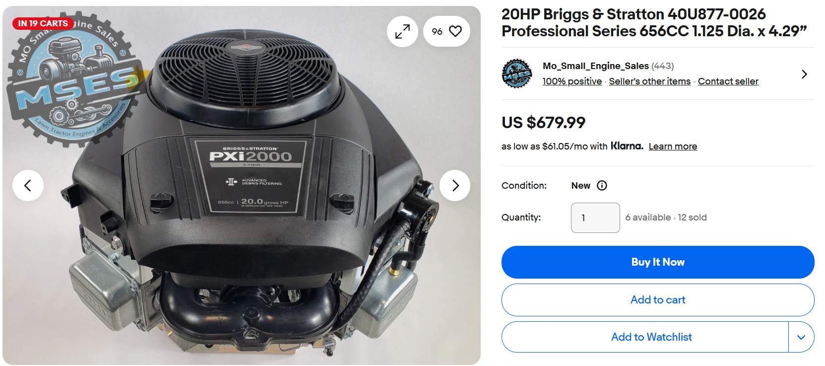

Date Posted: 07 Mar 2026 at 12:09am
here is another version... NOTE the shaft is 1-1/8 instead of 1 inch... so you have to VERIFY as they make a couple different sizes..
