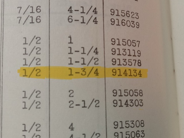

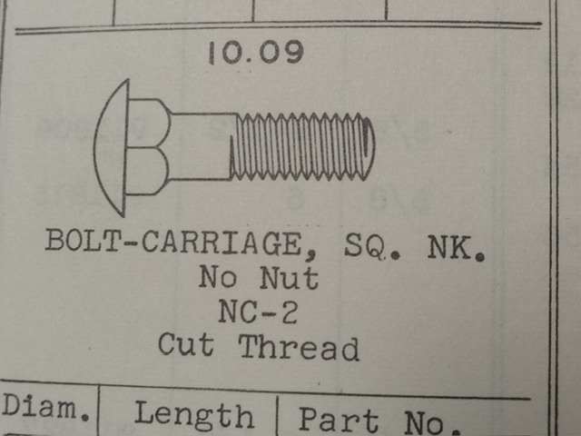

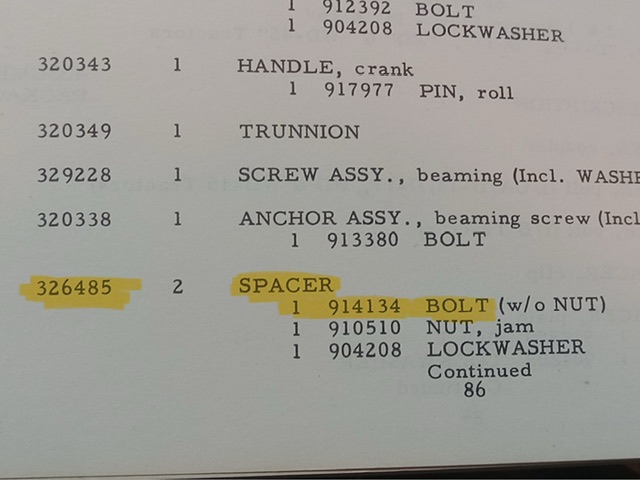

Posted By: Mikez
Date Posted: 24 Oct 2025 at 7:46am
Posted By: Mikez
Date Posted: 24 Oct 2025 at 7:48am
First picture is from plow book for spacer and bolt. Second, third picture is from standard hardware book.
