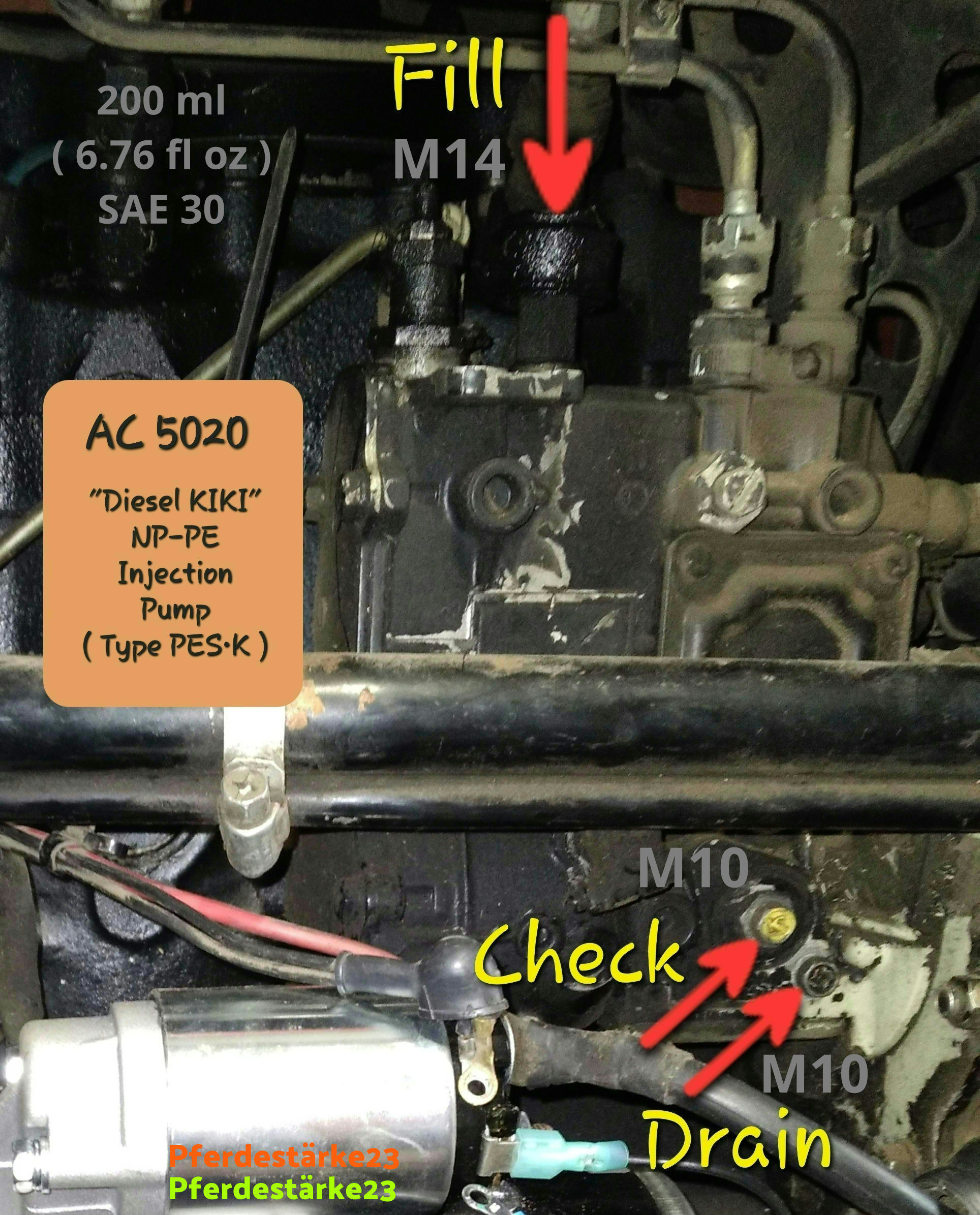

I would appreciate it if someone could post a picture of where to drain oil, check level and add oil  for the lube oil in the  injection pump on the 5030. Thanks

It doesn't appear that anyone is all that interested in helping you out here. Why now post a few photos of your pump from different angles. Maybe someone will offer some suggestions based on what the photos show.
Sometimes the drain, level, and fill points are glaringly evident, sometimes not so much. I've seen pumps where the only way to do it was loosen the back cover to drain the oil, then guess at the level when adding it back.

Do you have a manual for your 5030?  It does show the location in manual.    From a 5020 perspective the fill plug is on top of the pump and has something that looks like a breather cap that unscrews.  The drain and check plugs are towards the bottom and close together.   you can use a wrench or screwdriver on either of them.  The check plug is up and to the left of the drain plug.  I will try to get a picture later, but have been pretty busy of late.

Well, this is for my Fifty-TWENTY,
but since no one else seems to
feel obliged to help you . . .
The Check and Drain Plugs require a 10 mm wrench.
The Oil Breather Cap requires a 14 mm wrench.

I took the Pic to document the installation
of my new Offset Gear Reduction Starter.
( Which wasn't succeeding at that time . . . )
(( Just drop it in, my Arse ! ))
An old Pic was easily recycled . . .
And Boom,
I have left an  instruction book page  for myself !!!
( And now I have a nifty Pic that can be reused by many !  )
