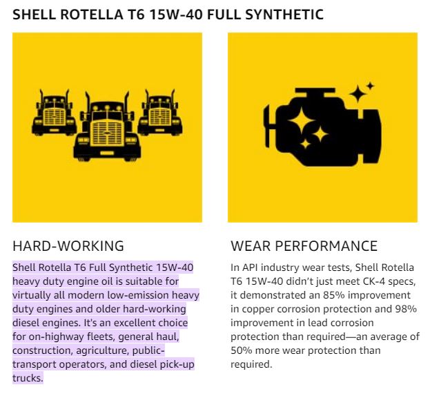

AS i mentioned in one of the previous posts, may of the "after market" Universal Tractor Fluids list 30 specs on the back of the bucket... Many of them say  "RECOMMENDED FOR xxx"   ....They do not say "MEETS OR EXCEES MANUFACTURERS SPEC".... so it is the OIL COMPANIES opinion that they oil is "as good as xx"  ........ When you buy HYTRANS, you are getting that guarantee.. ( i think).
This is from the CASTROL Page on Universal Tractor Fluid  --- again, i might just be "words"... i have no way of knowing.

Posted By: SteveM C/IL
Date Posted: 14 Dec 2022 at 8:34pm
I was thinking Traveler is a Warren product.
Steve...maybe they were referring to plain 15w40 dino not the full synthetic? Could still be BS.

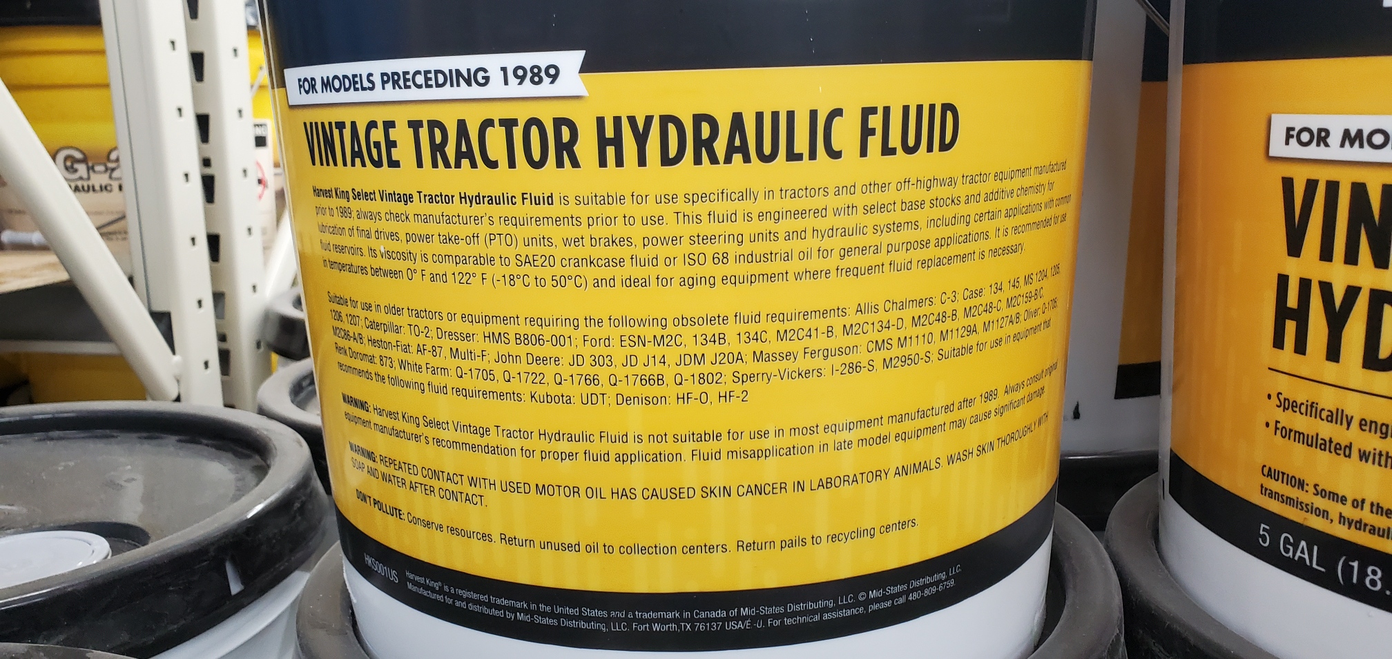

Seen this stuff at local Farm and Home store today . 49.99 for 5 gallons. The "modern" stuff that is for tractors manufactured after 1989 is 39.99 for 5 gallons

Date Posted: 18 Dec 2022 at 6:05am
"Vintage" oil is a marketing ploy, and not always less expensive, at least to the buyer, as you noted.  Do a bit of research and I believe you will find the "modern" oils/fluids are backwards compatible to the "older/vintage" ones.  Why would a manufacturer want to add more products to stock and deal with, other than in the cases where the product was going into new hardware that is not similar to existing.  John Deere doesn't sell 303 Special Purpose Oil, J14A Hy Gard, J20A Hy Gard, the current J20C covers all of them.  Same applies to the AGCO fluids I believe.  Look at the manufacturer specs an oil/fluid covers and go with the newest.  And if you cannot find the specs for a product on the container, or a Product Data Sheet for it, I suggest avoiding use of said product.
Backwards compatible, yes, exactly my point earlier as well!  Agreed!!
