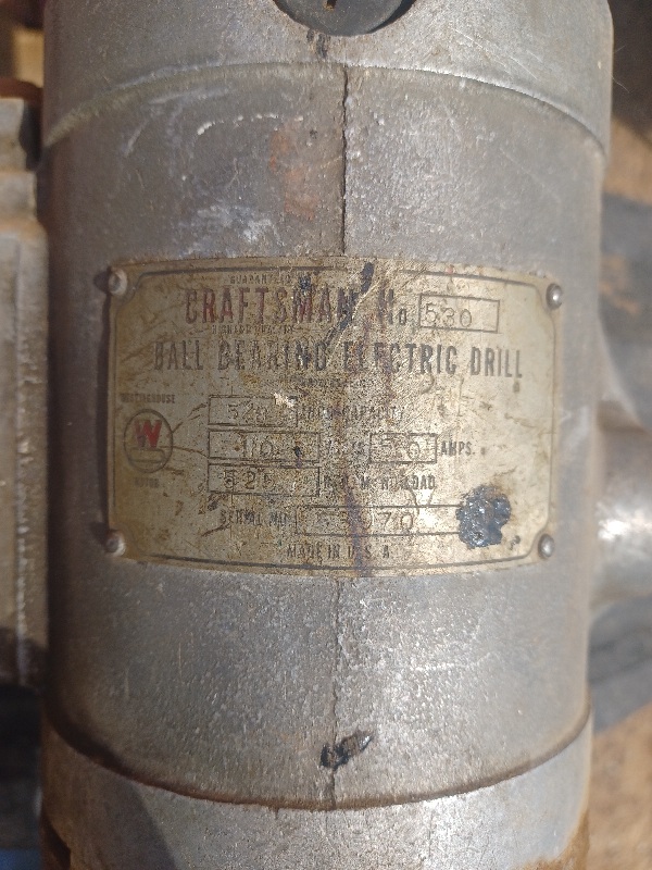

Joe, does your drill have a model number ?  I found this.. THIS one is 5/16 bolt.
https://manualzz.com/doc/1702974/craftsman-315.101280-owner-s-manual" rel="nofollow - https://manualzz.com/doc/1702974/craftsman-315.101280-owner-s-manual

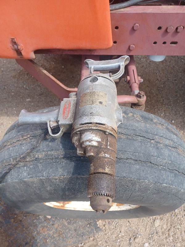

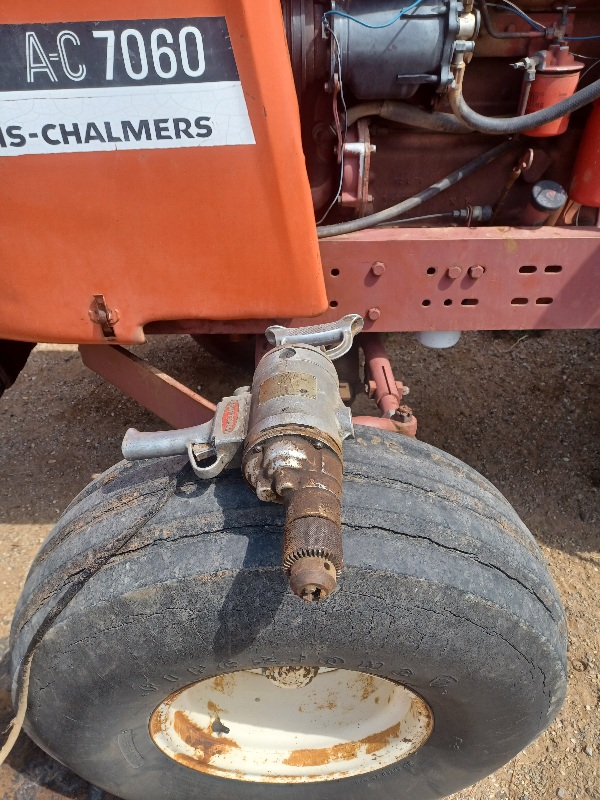

My dad got this MONSTER at a farm auction prolly in the late '70's,,it will hurt you if ya don't watch out, if ya can read the size,,it's 5/8"..
BTW,, if anyone knows where there's a press adapter for this monstrosity, I'd like to have one

 Hey Steve,,,YEA,!!  that is the exact drill as mine,,the tag is just about gone on mine but last 3 numbers are 280,,,, same as the one you postedClap  Well,, we now gots a PN for the bolt,,not that anyone has one in a Sears store hid out somewhere,,,?? I called that outfit you sent that link on this Am but it was too early and not open yet,,then I got to applying the grout on the floor project and thats where I amLOL
  Dang,,,,Michael,,that right there is a BRUTE of a drill ,,ain't it,,,??  CHIT ,,I'd be scaird to use that big sob unless I could chain it down to the loader on the D14,,,,,What is that part you looking for on the big ole Drill,,???

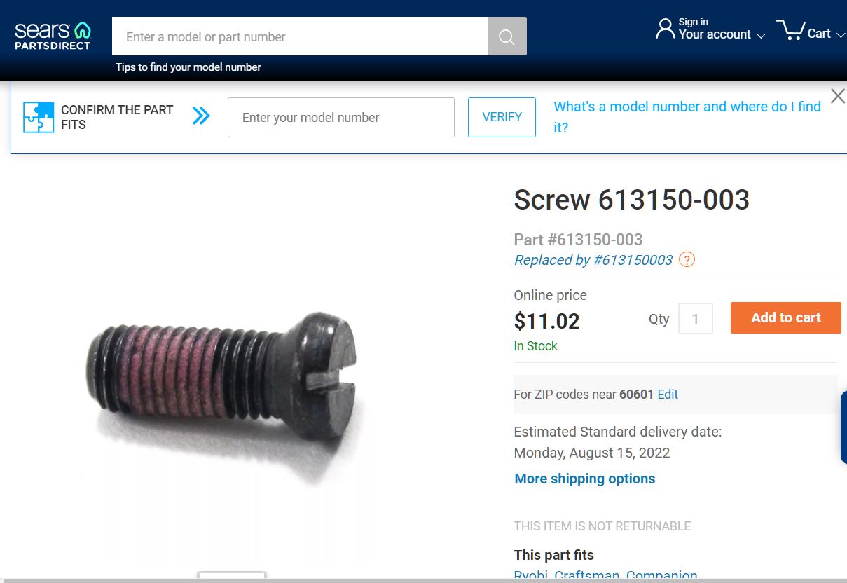

joe... believe it or not , SEARS still sells that SCREW !!.... BUTT, BUTT.. the above manual says it is a 5/16 inch left hand thread.... BETTER CHECK !!

 STEVE,,,you ARE something else,,,,!! Proud to call you my Friend,,!!  I had gone to the hardware store and looked thru their bolt section and tried a 1/4" fine on the shaft but was a tad small,,so then tried a 5/16" fine thread and it fit better but hard to say definately because these were not left hand thread. I'm pretty sure the 5/16 one you fount will do the job !
