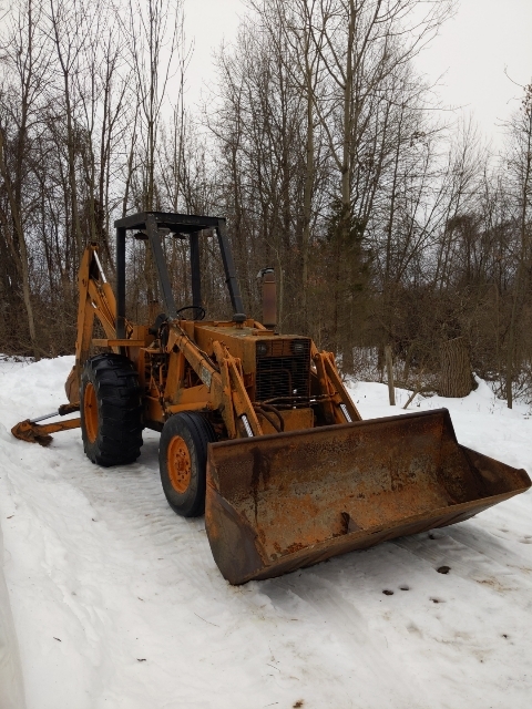

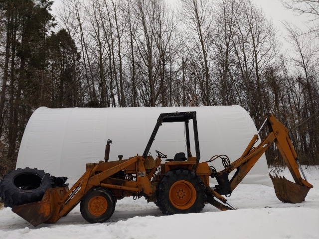

Date Posted: 15 Feb 2022 at 8:26am
Brought a 1972 580 b home! Post pictures later... It needs new rings as it does smoke a bit but really strong otherwise.
It's a wet sleeve 188 d diesel motor .
How far should I tear it down to replace rings/ sleeve s? Thanks Matt

Posted By: Dave76
Date Posted: 15 Feb 2022 at 5:24pm
Hunt, that is a nice looking unit looks like you found a pretty good one. Ed gave you real good advice.

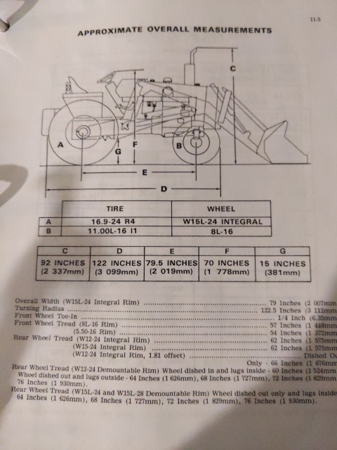

The other issue I have is the front tires need replaced and they are marked 9.00-16. My manual for this says front tires should be 11 l-16? How do I make sure that 11 l-16 will mount on my rims that are on the tractor? The rims from the manual say they're 8 in or 8 1/2 so I would think an 11-in wide tire would mount on it if that's what rim I have.
Since they are 9-in white tires and not 11 like the manual says someone probably changed these to 9 somewhere along the way but I want to make sure of my rim width before I buy new tires and also I'm asking just to make sure that I'm looking at the manual correctly? Thanks Matt

Yes you're looking at the manual correctly. You can measure the rims on the outside while the tires are still on. Measure the best you can from each side to the center and add the two measurements together.

The tires on it say 9.00-16
All tires that are new say 11-16 but actually measure 9" wide at tread so as long as my rims that are on it are 8" wide I'll look at getting what manual calls out being a 11-16.
